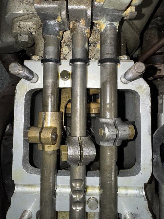

                  Will need to dig deeper into the gearbox, but not sure how to proceed. Possibly a synchro on first, which is supposed to be a bit weak on a Series III. Thanks for your suggestions, Robert

                    it all looks normal, the idea a syncro is cockeyed on the cone or something down in there is no doubt the issue. sorry robert but it looks like you'll be yanking that xmission out of there. at least it happened at home with decent weather. take heart, it's just something all of us deal with after driving these rigs into the dirt. make sure that shift lever moves outside of the box now that you have it on the bench !! and try actuating that rod in the box, maybe move it side ways, twist it some or something, i'm sure you tried this.

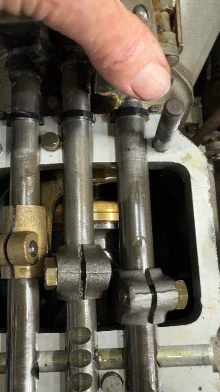

                      Yep, Borescope is next. We'll see what that reveals. I figured gearbox would need to be removed and have planned accordingly positioning the truck in my shop so the engine hoist has access to the truck and the workbench. Robert

                        The problem is fixed, but I don't know why. In the process of using the borescope I must have moved the fork rods enough to free up the binding of, I assume, the 1st-2nd synchros. Should they be replaced as a preventative measure? My plan is to drive a while and see if the problem reoccurs. Thanks, Robert

                          I think I'd proceed and pull the gearbox and take it apart. Could have a broken syncro spring (or something else) that had things jammed and will do it again later.
