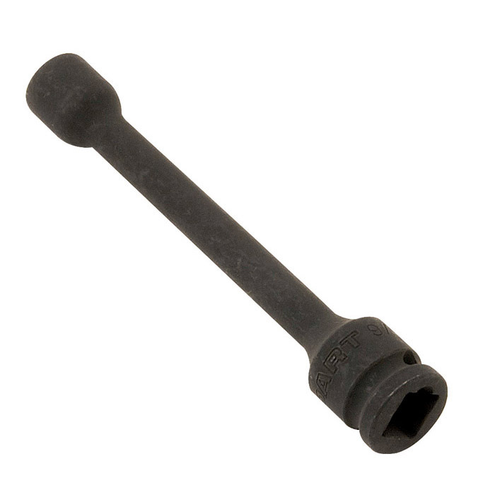

      IIRC the parking brake drum is held in place by the driveshaft flange and bolts so no chance of removing the drum first. As previously stated, use a 9/16" six point socket and align as straight as possible. Our host does supply a special extension / socket made specifically to access the prop shaft nuts. It is part number RNT141.

        Well, I got the out eventually-after heat, Kroil, PB Blaster and cursing. I had to resort of cutting the yoke apart that holds the u-joint in place, then hammering out the u-joint. With the old drive shaft off I could get a socket completely on each nut and turn them relatively easily. The threaded shafts were undamaged, so I could just use new nuts with plenty of anti seize and I hope that will make next time easier. I put in a new drive shaft anyway so it was no loss to destroy the other one.
        BTW the brake drum is held on with separate nuts on separate studs, but removing them didn't seem to make a difference. There's very little clearance around each drive shaft nut so I couldn't get a socket on them at all with the shaft in place, even when it was detached at the rear and could be moved around. I was trying to just drive out the u-joints and remove the shaft that way but the yoke bent from all the hammering and I ended up just cutting through it.
