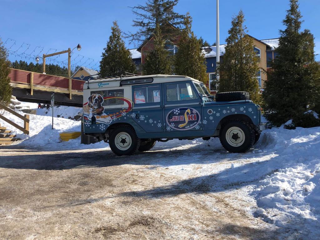

Good morning, I am the new owner of #720. Drivable, but needs some work. Still has the original 6, although the air cleaner unit has been replaced.

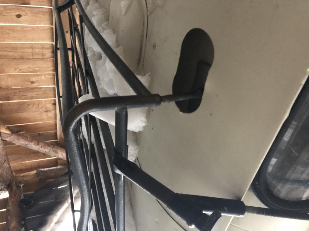

Here's the worst PO mistake (I hope)!Comment
