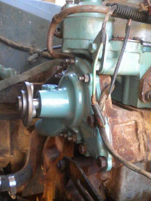

      No more leaky n squeaky.

        radiator
        Taking the radiator out is cheating!

          Agreed! That's why it stayed in place. The fender was already off for the clutch/brake/steering box work. The pump passed a pressure test initially, but after sitting for 25 years, and a vinegar flush upon fire up, it gave up it's last legs and started to squirt.
          Creative camera angling kept the radiator from view.

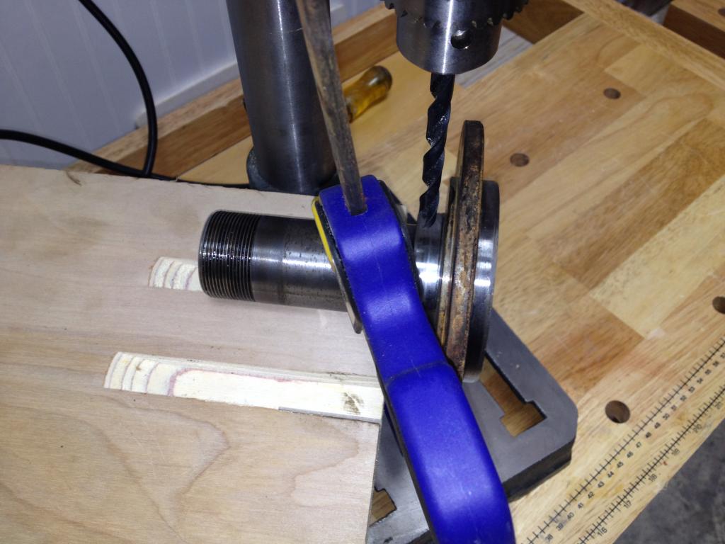

            Replaced Front Hub Seal Race by building drill press jig to drill out race since pounding with cold chisel was not working well and risked damage to stub axel.Click image for larger version
