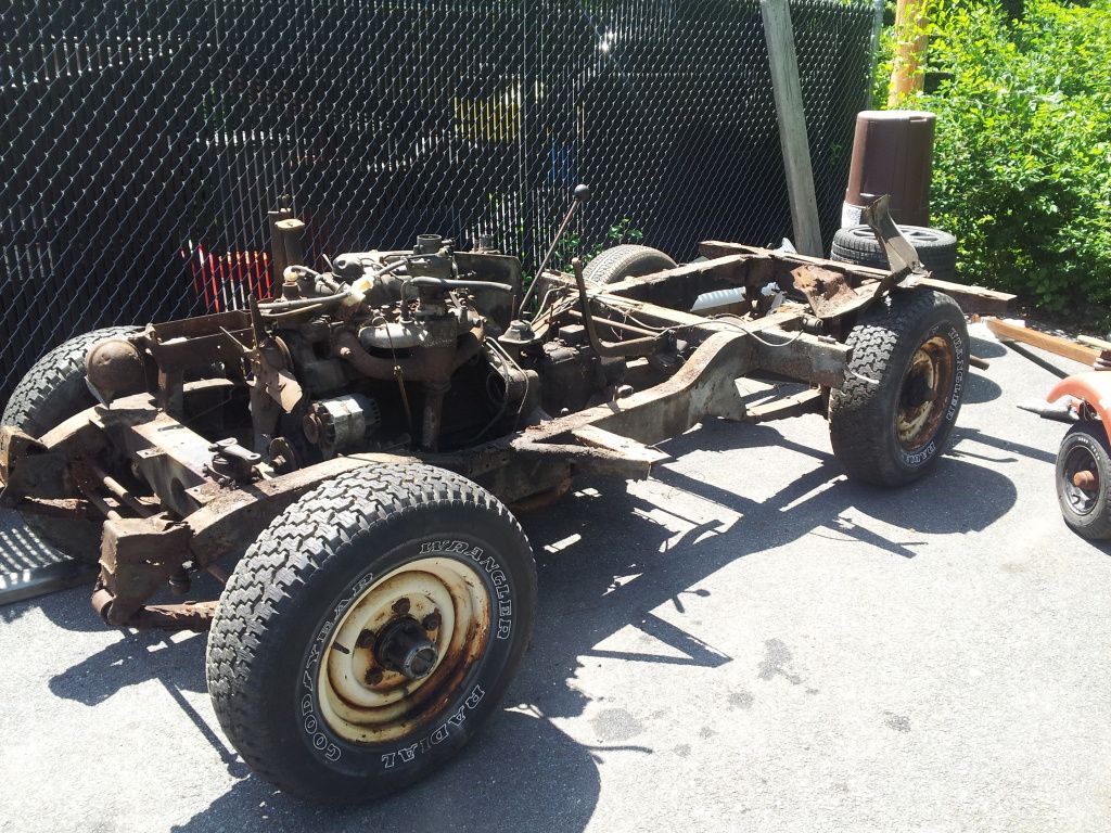

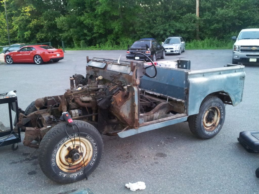

                          Moving along... got the rest of the body off. Trying to make time to pull the motor and axles, then I get to play around with my plasma cutter and chop up this mess.
