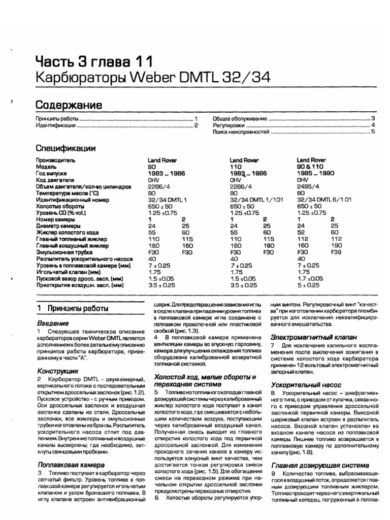

I'm back at it...
So for a while I've had this problem, but had been more focused on other things. Wander's recent thread about a gas smell in the cabin prompted me to dig a little deeper into my own issues.
I started with the timing gun this morning, boy was that sucker out of time. I pulled up some old notes that Jeff A had been kind enough to write and found this:
My 2.5L has 5 or 6 marks with a 6 Degree mark on the left most mark. I set it smack in the middle
when I gave it some gas, it popped a few times, then backfired badly and died. So I move it to the 6 degree mark, popped and gurgled more with gas... so I went to the far right which was not much better either... so I settled on the middle.
It sounds much better at idle now, but still requires some choke, even when hot. It also pops (unburnt fuel in the exhaust?) when I let off the gas.
The hesitation at full throttle is better, but still present.
Any thoughts? With a little choke, and me ignoring unburnt fuel pops, it does seem to be running better now...
(for the record, I'm close to blaming the seafoam)
So for a while I've had this problem, but had been more focused on other things. Wander's recent thread about a gas smell in the cabin prompted me to dig a little deeper into my own issues.
I started with the timing gun this morning, boy was that sucker out of time. I pulled up some old notes that Jeff A had been kind enough to write and found this:
If it's not, then stop the car and loosen the distributor clamp nut somewhat, leaving enough tension so it's not moving on its own. Start the car again and slowly turn the distributor; with the strobe light on you'll see that the light hits the pointer/notch more exactly. Once they are lined up properly, then tighten the clamp bolt and you're all set.
when I gave it some gas, it popped a few times, then backfired badly and died. So I move it to the 6 degree mark, popped and gurgled more with gas... so I went to the far right which was not much better either... so I settled on the middle.
It sounds much better at idle now, but still requires some choke, even when hot. It also pops (unburnt fuel in the exhaust?) when I let off the gas.
The hesitation at full throttle is better, but still present.
Any thoughts? With a little choke, and me ignoring unburnt fuel pops, it does seem to be running better now...
(for the record, I'm close to blaming the seafoam)
