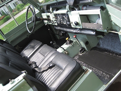

                      On the wife's SIIA 109 I mounted the radio in a box mounted to the bulkhead behind the center seat. You won't have as much room in an 88.... The CD doesn't really work at the angle it is mounted, but we usually use the ipod or Sirius radio plugged into the audio input jack anyway. It can be a pia as you need to fold down the seat to access the controls, and take your eyes off the road, but once you remember the programmed buttons it is no big deal.
                      One set of speakers are mounted in the Defender door panels, the other set is mounted to the flange where the top bolts to the side panels.
                      I used marine quality radio and speakers for a bit of weather resistance. Some dynamat in the doors and seat box helped with noise reduction.

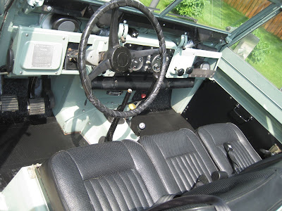

                          I did this. Here are a few photos of it, finished. Note the small module above the guage cluster. It is the power switch. The amp is tucked behind the guage cluster panel. I have the speakers just sitting where you see them. My Ipod plugs into the input wire dangling below the steering wheel. I have velcro stuck to the dash, and the back of my Ipod, so I can just stick it up there while I drive. That way, I only have to use one hand to operate it.
                          It is not the greatest sound, but it is waterproof and not as invasive as other options. If I ever sell it, I don't have any permanent remains of this system.
