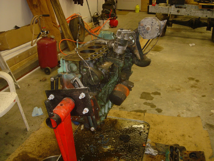

              • Tim Smith
                Overdrive
                • Nov 2006
                • 1504
                #8
                Originally posted by Jim-ME
                Do yourself a favor and buy an equivalent. Don't but FRAM.
                Jim
                Or else your motor will look like this.
