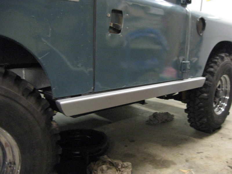

                I recently built a pair of sliders for my 88. I didn't cut the slider to accomodate the bulkhead outrigger as I wanted them to sit out for side protection.
                • Pete
                  Low Range
                  • Jan 2007
                  • 93
                  #38
                  sliders
                  Here's a couple of the finished product.

                    Looks good Pete. I will have to get some pics of mine posted.

                        Very nice...
