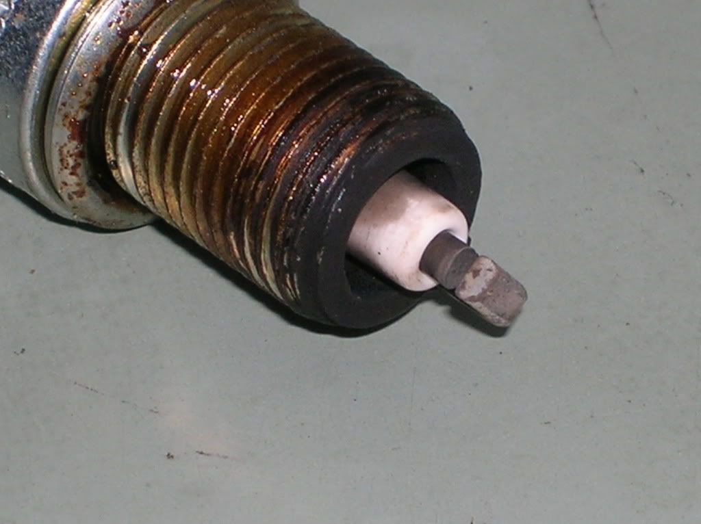

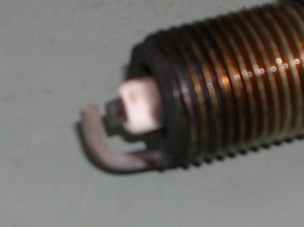

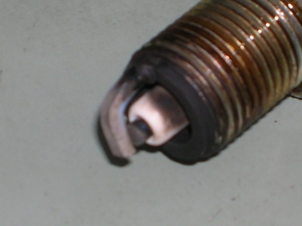

                        OK, kind of odd, you guys may be on to something.
                        1. As I slowly closed off the air intake the engine rev'd way up, not what I expected.
                        2. Here are the plugs:
                        To add: I haven't touched the timing. My rule of thumb is that if it starts right up, accelerates fine, and stops right away...the timing is pretty close.

                            Have you tried the 53 jet? If it's worse than before you rebuilt it, then I'd look first at anything that's different. I'd probably take it back apart and make sure something didn't get put together wrong (we've all been there). It could also be a blockage somewhere, so try blowing out jets and passages with compressed air. The plugs look too lean.
