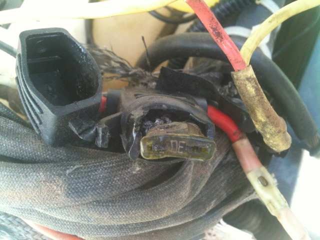

        Checked the fuse links. PO had added two in-line fuse holders to two of the links. One of the fuse holders was a melted blob! Replaced it. Everything works! I will be adding a fuse block to replace all the fuse links. Any problem adding resetting breakers instead of fuses?

          That's the image that comes to mind whenever the phrase "a hot mess" is used. For your fuses, I'd go with the regular blade type but get the ones that light up when they are blown. I don't remember the brand name but they're easy to source.
