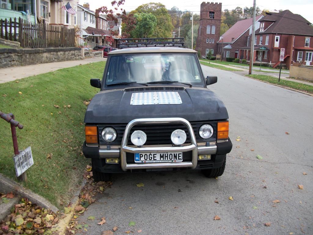

Not having found a brush bar at a decent price, this model having the Crush Cans. Instead of chopping off the Cans and retrofitting a bar for an older model (and causing a problem with the SRS), I installed a stainless steel Bull Bar from a Disco. All that I needed to do was ream out the mounting holes in the frame from 7/16" to 1/2", and bolt it up. Even the plinth cover fit right up. It's a really different look for a Range Rover. Hope this helps someone out there.
How I replaced a 95 lwb brush bar
