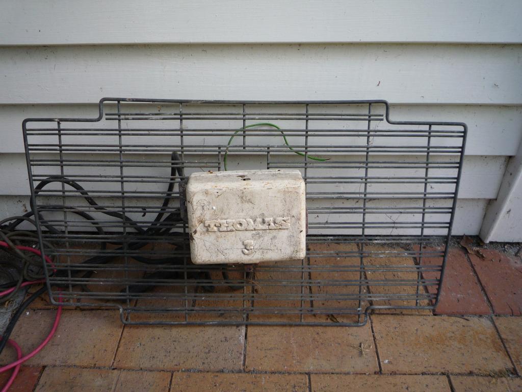

            Originally posted by ThePhotographer
            Series III have plastic front grilles not metal,
            Not strictly true. I have a metal Series III grill under the house. It is genuine Land Rover and has the Series III shape, but is metal.
              I'd like to see a picture of that, I've never seen(or heard of) one, maybe they never came to North America?

                Here ya go. It came from a Series III flat deck my wife's cousin used to own. It came to me with the Thomas winch now on the front of my Stage 1, which it why the solenoid box is still attached to the grill.

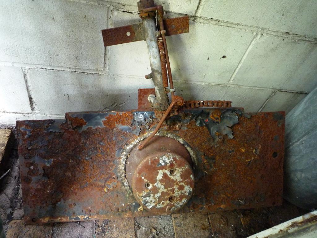

                As a matter of interest, here is a snap of a recent score, capstan winch to restore (it's a heavy damn thing)

                  Alan - I wager that metal S3 grill is a Kiwi thing. Everything on your island is the same but just a little bit different.
                  Ol' Ebben in VT could probably rely on the metal versus plastic test for any rover dug out of a barn in New England.
                  (Cool capstan by the way)

                    haha that is true, even the crickets are "different".
                    About the grill, Ozzie and Kiwi, correct. The plastic ones tended to get smashed up on the farm too quickly.
