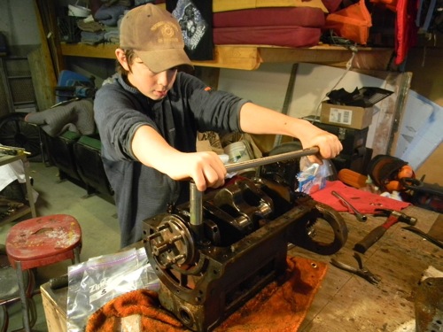

14 year old seeking advice!

The sludge is old oil mixed with various nasties that both come with oil and from the engine itself. Oil does more than lubricate, it also acts as a way to carry by-products of running away from those parts where it can do damage. Things like carbon deposits, metal grindings, sulphorous compounds, lead compounds (in countries that still put lead in petrol), etc. Mostly, these get trapped in the oil filter (which is why it needs to be replaced regularly) but smaller and heavy particles stay in the oil, which is why you need to replace the oil regularly.
Before running the engine, I would advise you get some engine flush and flush out the engine. Maybe even take the sump off and clean it out. If you take off the rocker cover you will probably find a lot of the same muck in there. While you're at it, pressure flush the cooling system too. It is likely to have globules of coolant (like jelly) and grains of corroded metal (looks like sand) stuck in the galleries.
Turning over the engine while the spark plugs are out and the rocker cover is off will give you the chance to see that important things are working, things like the water pump, alternator, valves are going up and down, pistons are going up and down, carburettor is working and fuel pump is pumping, etc. You can set the timing too.Comment

first, to answer ThePhotographer's question, we're in norwich. near hartford, white river, and thetford.
now for the fun stuff... we finally got it home, and boy will we have a lot of work. all wheels are locked up, so that's the first project. then comes the engine, then if that'll run we'll do the frame. the body and interior are in good shape, so we won't have to mess with them. our plan is to get it running, take it for a few "victory laps", then park it in our new shed and tear the body off to do the frame. luckily, a lot of the rust is just "scale", so it'll scrape off. but don't get me wrong! parts of the frame will probably have to be rebuilt. we have a 95 year old machinist friend who said it looks like we can save the frame.. yeehaw!
here's some pictures: https://picasaweb.google.com/1088890...overSeriesIIa#
there's lots, i'll go through and clean them up... just wanted to get them up...
more of the undercarriage/running gear/inside soon... like tomorrow
ebbenComment
