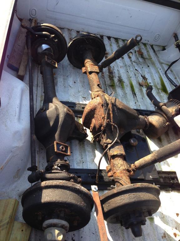

Sorry. Found original post on d90:
As for your engine choice, nothing wrong with a small block chevy, 'cept it's a cast iron engine so it weighs quite a bit more than the all aluminum Rover V8. The Rover engine with a mild cam and stage 2 heads will get the HP you want and you avoid all sorts of fitment issues. You can bolt up the Stumpy R380 to it and have your 5 speed, and an LT230 transfer case gives you all the low range you can eat.Hi All,
Found one Snatch Salisbury ft axle. Complete with arms. Comes off of a 1988 Snatch. Runs/drives now. Would assume all brake parts will need to be replaced.
Overall nice shape
$1450 delivered to Atlanta
Will be here in about a month to 6 weeks.

Still plugging along on this project and want a sanity check - There are two types of diffs on a '66 109", right? Banjo or Salisbury? If it's not one, it's got to be the other--- right???
Second - If paired to an NV4500, does it make most sense to convert to a 3.54 ARB air locker (24 spline) instead of the 4.70? I just want to make sure I've read this whole post correctly.
Thanks all. Pics soon.Comment
66' should have what you call banjo diffs front and rear unfortunately. 24 spline, ARB, 3.54 should be fine but pricy. You have to change front and rear gears if you go with the 3.54 though.Jason
"Clubs are for Chumps" Club presidentComment
Just to be clear, that isn't a salisbury front though. Just a regular rover diff with the better 6 cylinder brakes. Decent deal though if you're looking for a salisbury rear.Jason
