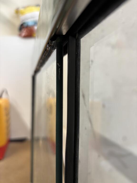

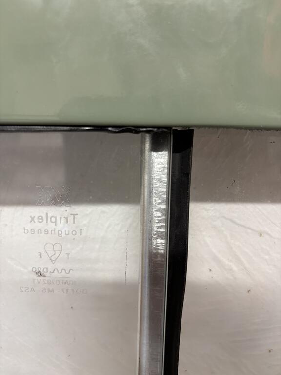

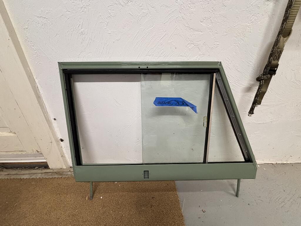

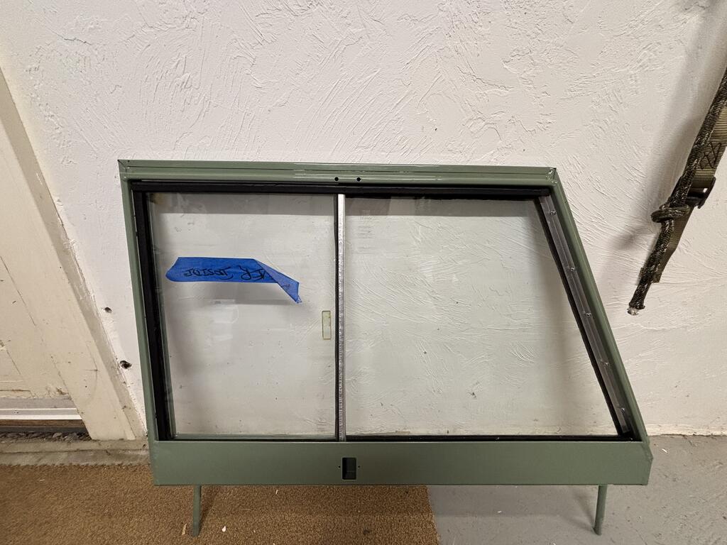

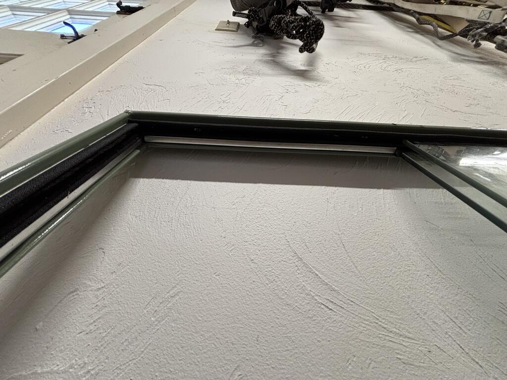

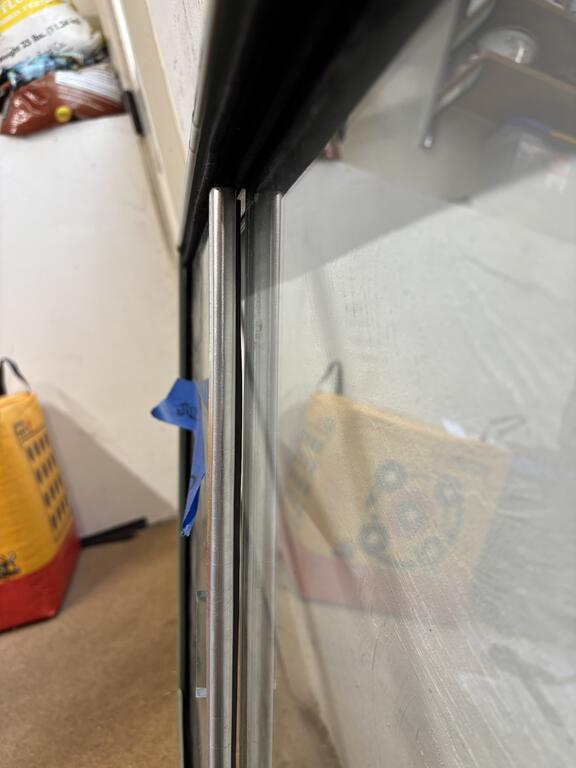

    I’ve just installed the sliding windows using our host’s door top kit ( Window Fixing Kit Series Door Top Model #: RNA0349). Once installed, however, the glass alignment seems off. The rear pane slides far back enough that the vertical rubber seal slides past the end of the front pane (see photos). I believe I did the install correctly and followed along a YT tutorial by steamwally. My only thought is that more aluminum shims behind the vertical felt track would fix the issue but look pretty bad. Any ideas to fix or identify improper install would be greatly appreciated.

    It's been forever since I've done one of these, but I wonder if the vertical rubber seal isn't deep enough? Is it new, or are you re-using original?
    Or, perhaps there's too much of a gap between the two panes of glass.

        Myron, the seals are new from Rovers North. When sliding, the seal does in fact make contact with the other pane. The issue is that once the sliding pane is fully slid back, the seal overshoots the edge of the static pane.

            Hey Jim. Glad to hear you got a deal. The holes seen up top in my images are for the older metal window lock which would be riveted on. There would be two holes though and probably smaller than 3/8”.
            If the current hole does not get in the way, you could likely mount the locks up top, seeing as there are no cutouts below.
            As far as the compound, my frames had some as well. Leftover sealant which did scrape away with some force.
