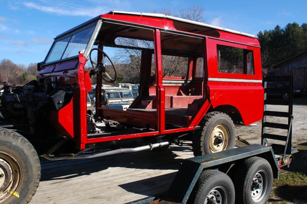

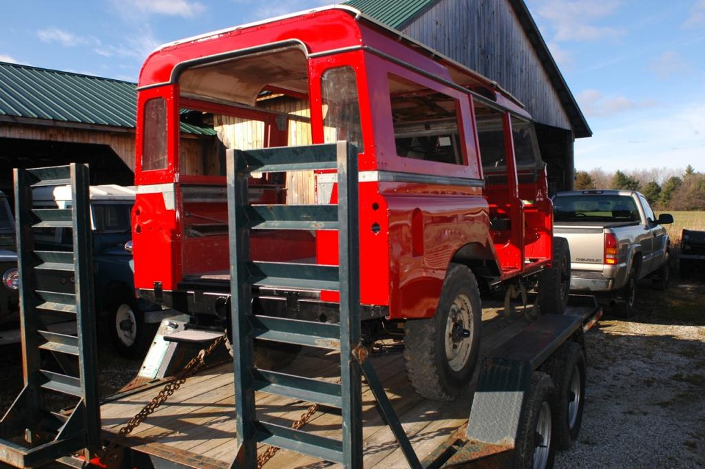

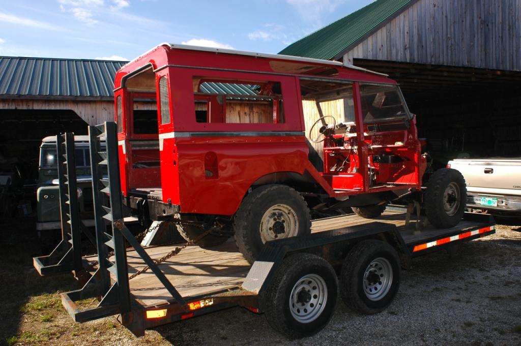

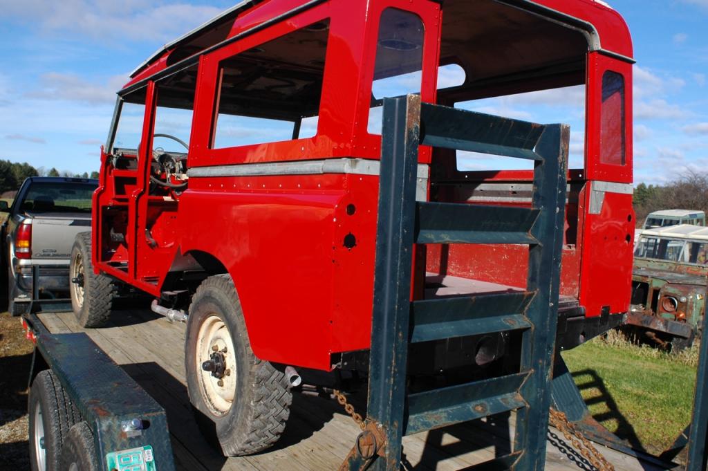

          The build continues....
          Steve

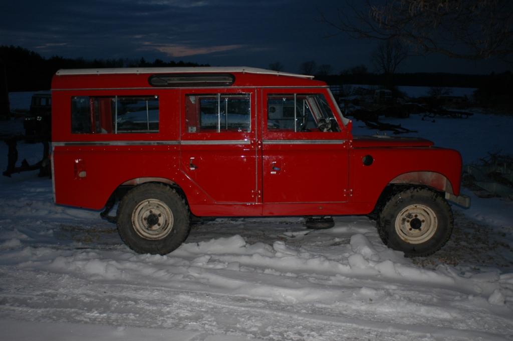

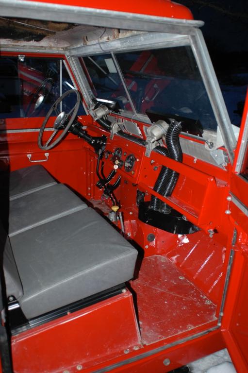

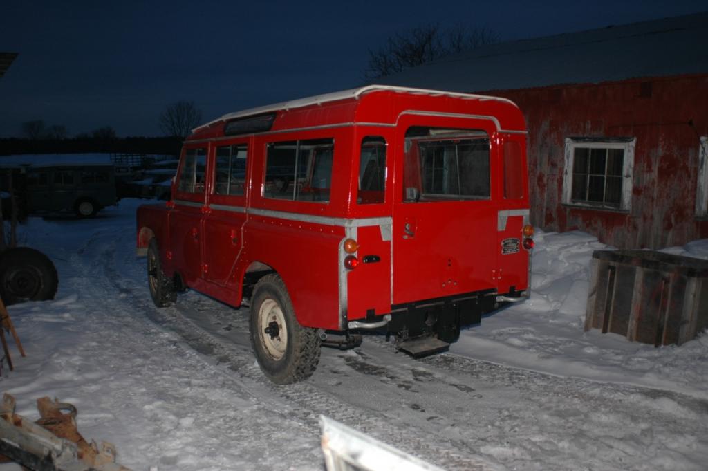

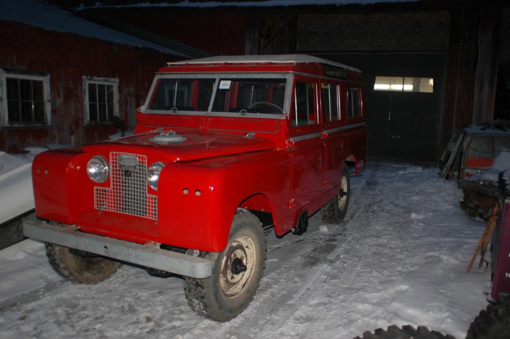

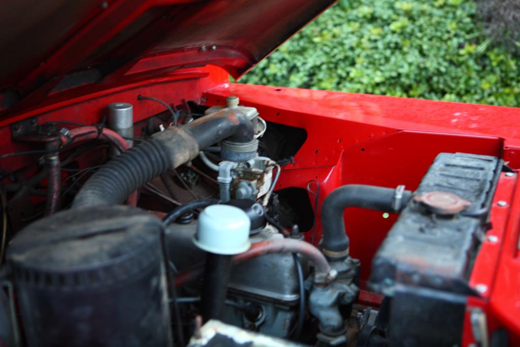

            And continues....

              Steve, did you use a Poppy Red color code, or just tell 'em "bright red" ? Limestone for the sunsheet or white?
              Looks great
              well faded, patchy, lumpy, poppy red here
              ~Steve
              ---- 1969 Bugeye ----
              ---- 1962 Dormobile ----
              • lighiche
                Low Range
                • Jul 2012
                • 83
                Looks great
                ~Steve
                Poppy Red color code. I repainted it because the paint on the doors and roof was peeling off in sheets. My primary concern was preservation of a remarkably solid 109. Had it retained a nice, relatively uniform patina I'd have likely kept it as was. I didn't paint the interior of the tub partially because of extra cost and partially because this is going to be a user so it'll get scraped up and mainly because I like the patina. I've buffed it up a bit and it looks fine, used but fine.
                Thanks
                Steve

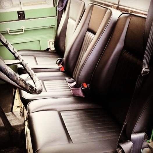

                    Fitted new seats in my 88. Click image for larger version

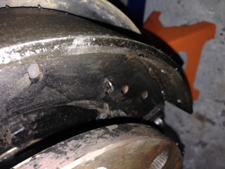

                            Replaced Right Rear Brake Pads. Previous ones were soaked with oil after hub seals leaked for many moons in previous owners barn. I had originally tried full can of brake cleaner to degrease, but after driving on them a bit, I checked them out and they looked like they were "bleeding" oil. Of course, I at first I mixed up the leading and trailing brake shoe position...
                            I saw some posts on an Aussie LR Forum that said to soak the pads in gasoline and "burn out" the oil since the pads are asbestos and will just burn off the oil. I figure for the price of a new set of pads from our hosts, I would save the burned eyebrows and just order new. I did see some references out there to the drums potentially being saturated and should be replaced, but I will try as is. The drums seem fine.
