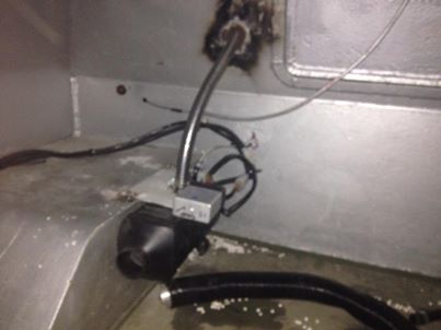

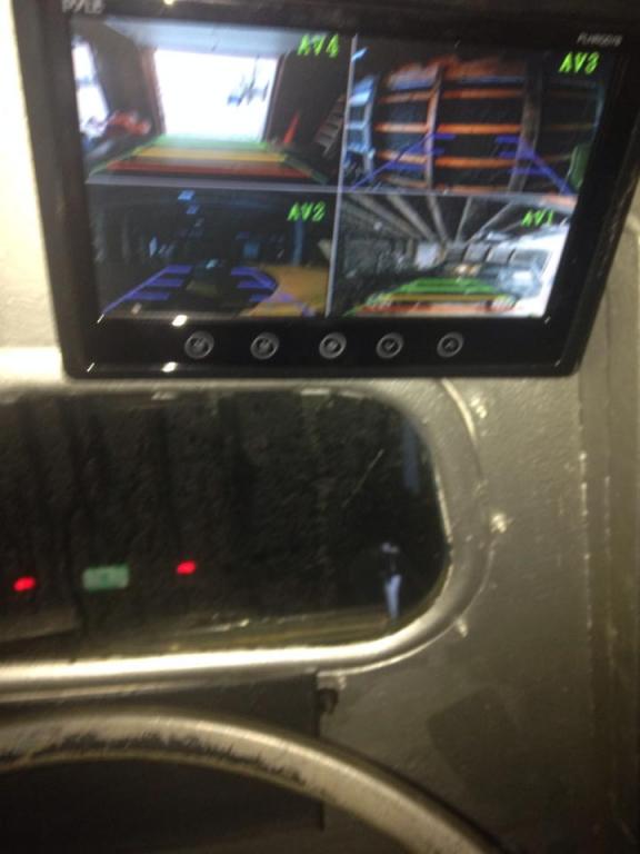

              added a webasto heater so I won't freeze to death and cameras so I no longer have to use the force to change lanes in Shorland

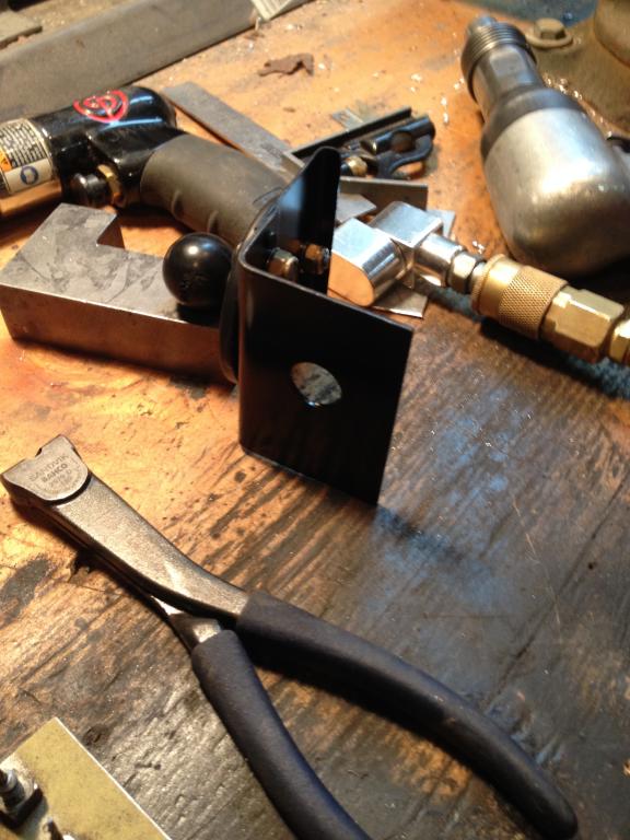

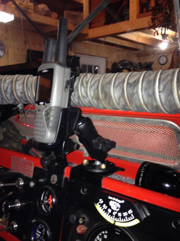

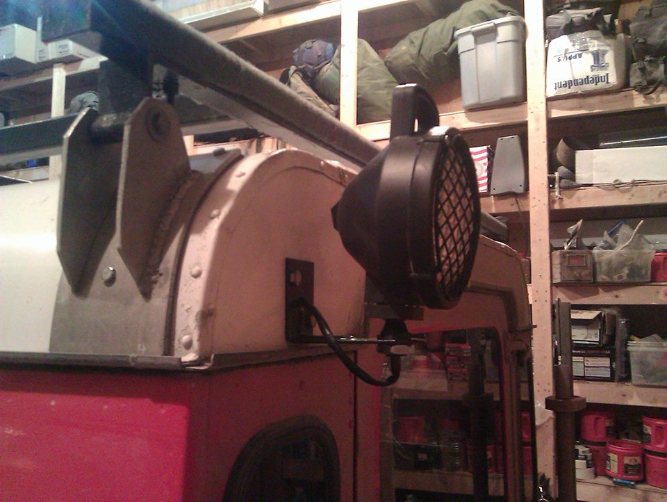

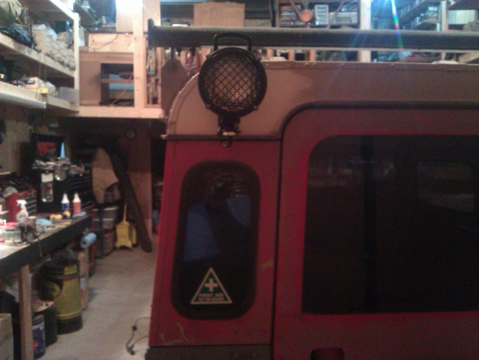

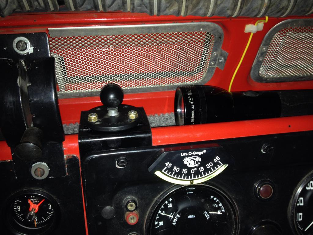

                        Spent the evening in the shop mounting my rover work light and fabbed up a mount for my Garmin Rino GPS.

                          If you spend any time on wash board roads the shaking of the light on the 'L' bracket will cause a fatigue crack in the roof along the edge of the steel bracket. Been there had that happen.
                          I suggest removing the bracket from the roof and filing a rounded edge along the bracket where the bracket meets the roof panel. When you reassemble add an aluminum back plate to the inside of the roof panel behind the steel light mounting bracket. The back plate should be thicker than the roof panel and extend wider than the lamp bracket. This will keep the roof panel from vibrating with the shaking of the light bracket on wash board roads.
                          Of course roof metal fatigue usually is not an issue unless you drive long miles on wash board dirt roads. BTW I like your GPS mount.

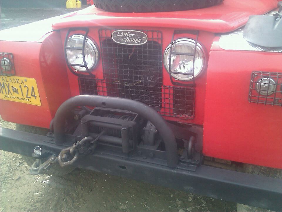

                            Originally posted by toga Rover
                            Where did you get those headlight guards?
                            I like that look.
                            Toga Rover
                            I had them on an old Mitsubishi (willys) jeep diesel we drove all over northern japan in the mid 80's. The Japanese where very eager off roaders and had all sorts of accessories on there trucks. Click image for larger version

                                Nice roof rack, did you fab this up?
