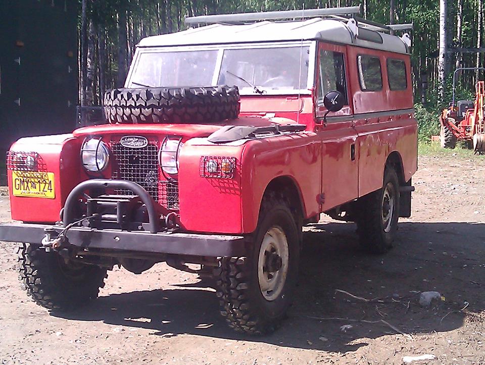

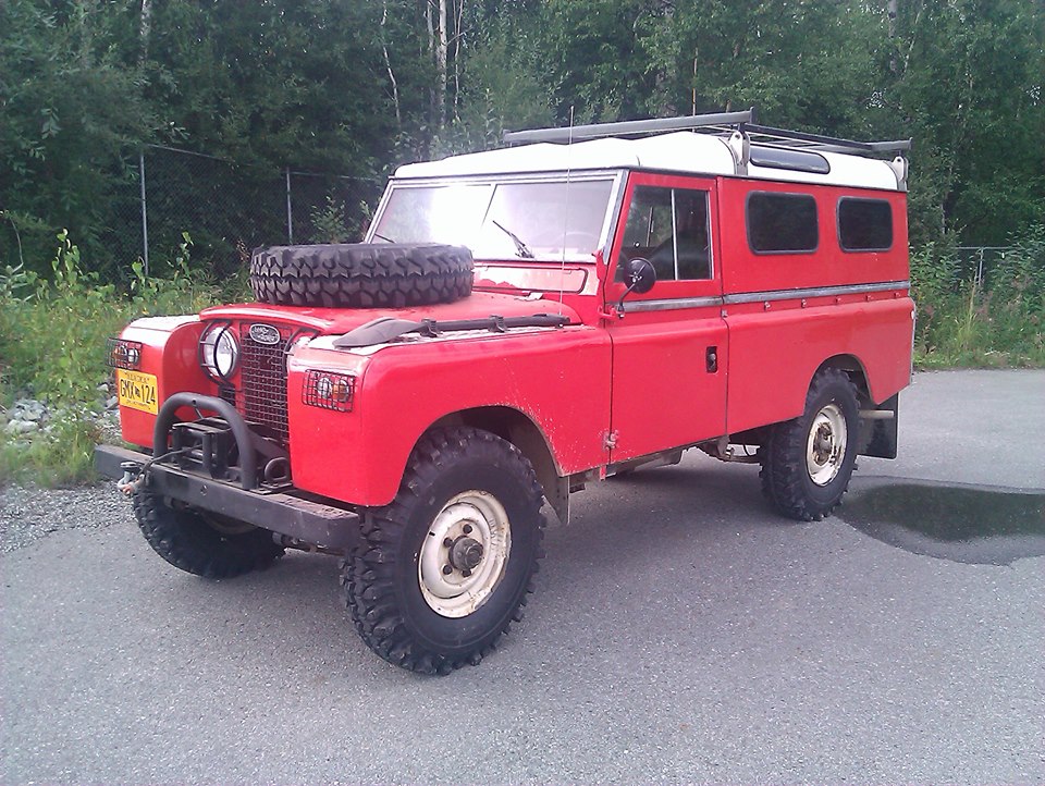

        Finally got my 34X9 TSL's mounted on stock rims.

            Hey Alaskantinbender, What tires are you running? (TSL)? I love the look of those!!!
            • alaskantinbender
              Low Range
              • Dec 2012
              • 52

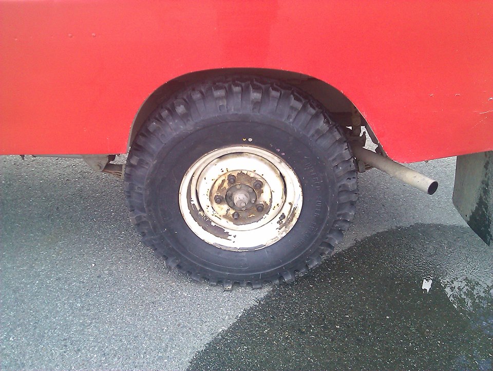

              Tall skinny (only 9 inches wide) TSL's.
              They just fit in the wheel wells with 1 inch spacers on stock rims. Without the spacers the front tires rubb on the leaf springs.

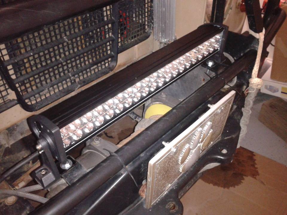

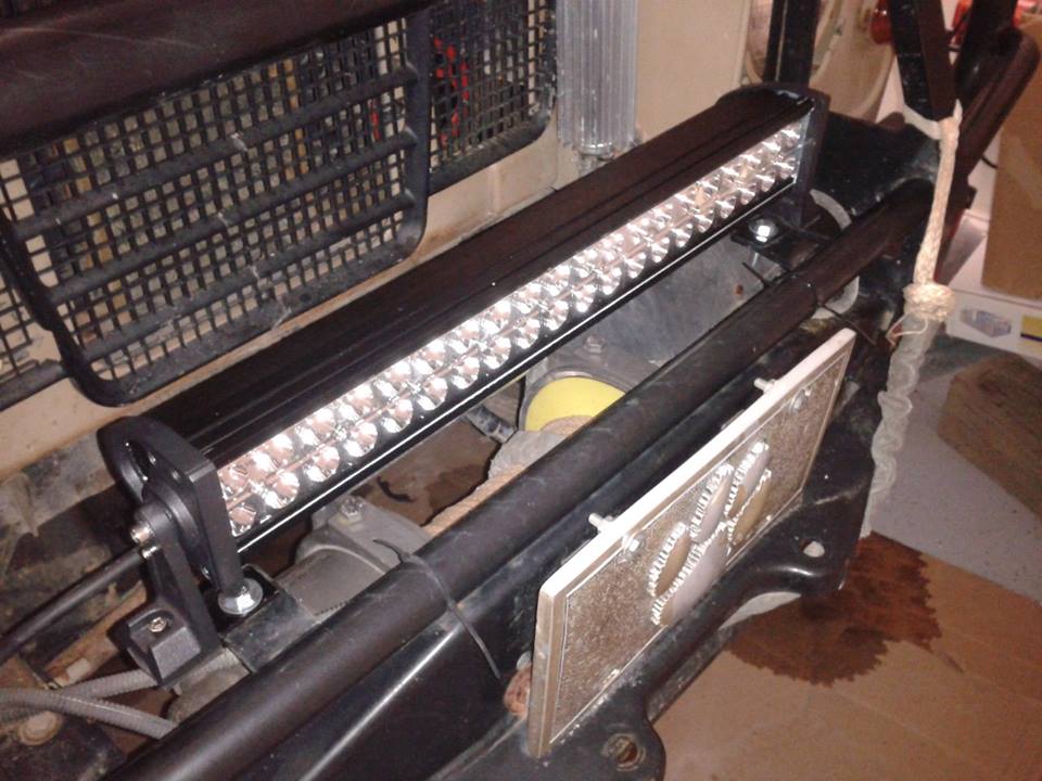

                            Got my LED light bar installed. Garage test indicates it is very, very, very bright.

                              Would love to see a "full frontal" picture if possible.
                              Thx.
