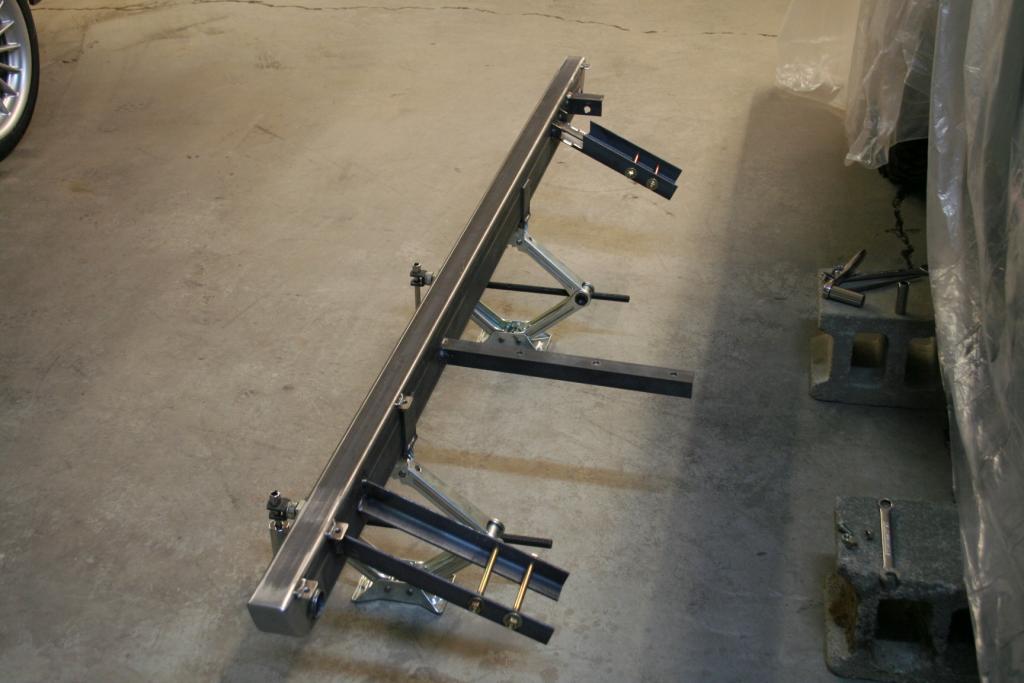

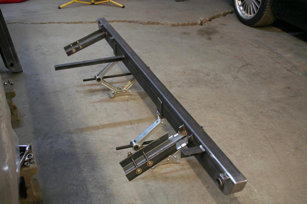

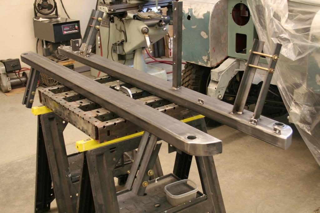

Nice work... looks great.Didn't really do it today, but did just finish up a pair of rock sliders for my 109 military framed 3-door...........thanks to Ike for the design ideas. About a weeks worth of cutting, grinding, shaping, and fitment.

I might add that when off roading I have seen willow branches get caught between the slider and the fender, I think the front and rear should also attach to the inside of the fenders, not for support but to avoid anything getting caught in between. A simple strip of metal across with some self tapping screws would suffice, better yet welded to the slider and bolted through the fender.Last edited by busboy; 02-19-2013, 03:47 PM.1971 series 2a 88, series 3 trans, Fairey OD, owned since 1978.Comment
