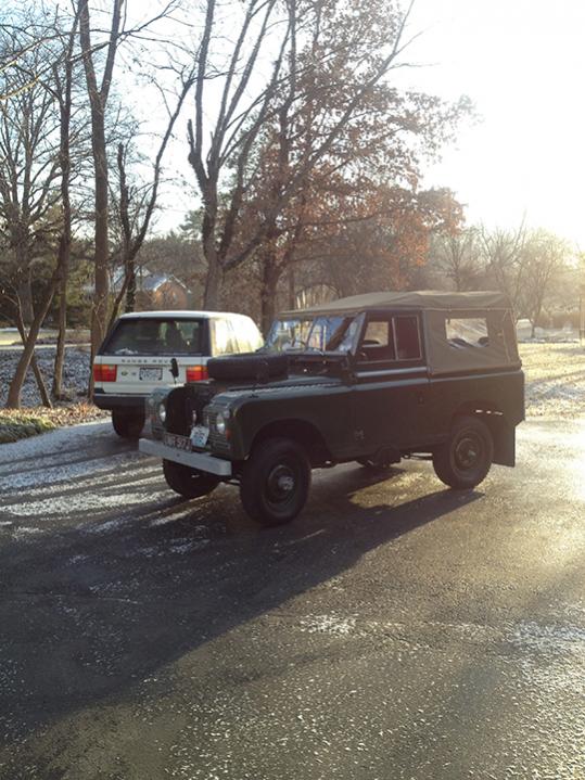

            Drove to work!Click image for larger version
