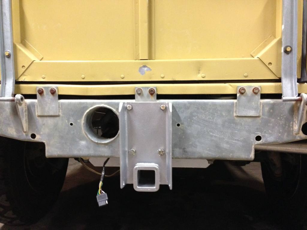

                Installed the Rovers North hitch today. Kit fit perfect except for the lack of nuts in the hardware packet. Now it's ready to pull the sailboat...in about 6 months.

                    Yeah but will you stop dropping the tailgate on the hitch ball now?

                      That way when I bought it. One of the first things I did was complete the tailgate so that crap won't happen again.

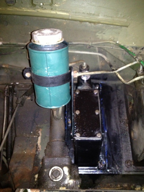

                        Finally finished restoring and re-installing of master cylinder reservoir after sourcing a DOT 4 resistant washer for bottom of can. Let's hope it does not leak. Tried to reconnect new RN brake line to old type CV brake master when it looks like the new brake line I installed has a connector that is smaller than the old one (?). I either have to start over and get a brake line connector that fits or find an adapter to bring it from the smaller size to one that fits the 109 CV Brake Master.
