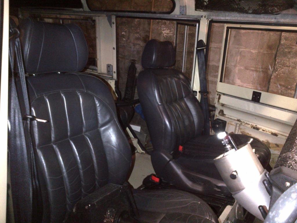

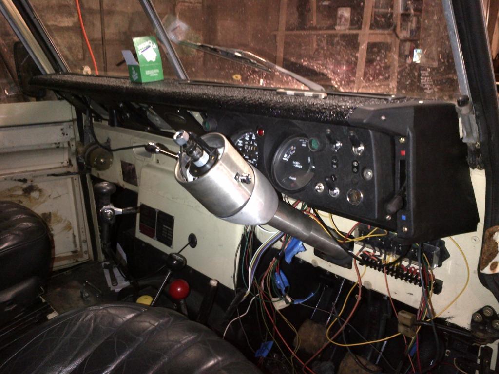

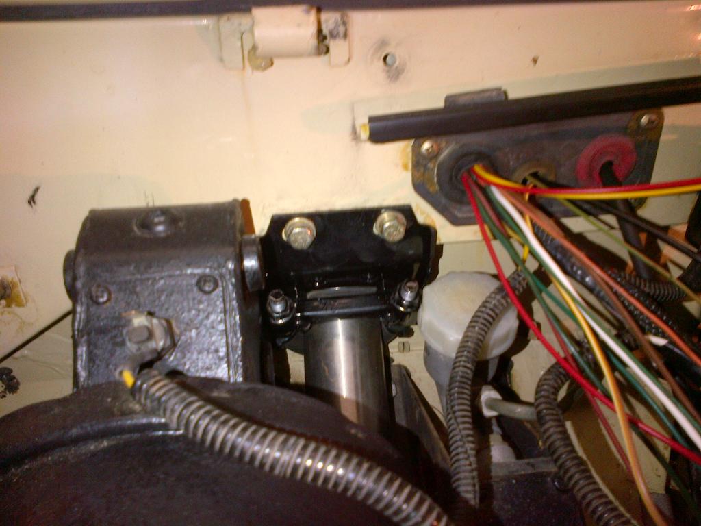

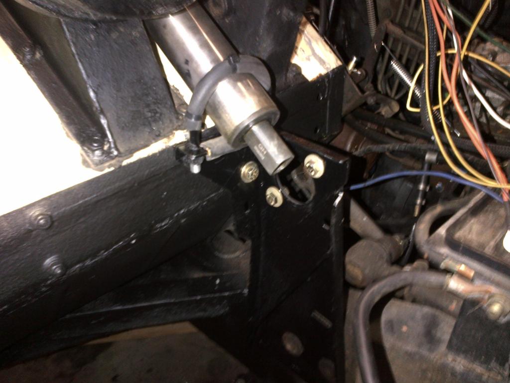

After months apart I finally started the re-assembly of the Dash and wiring. I also got my new seats and seatbelts installed in my 109 5 door with about 2 inches of extra travel- the next challenge is rear seat from the same donor. I also took a first crack at the flaming river steering column upgrade. Made custom brackets pictured here that almost look stock. The tilt wheel will be very nice with my uh - extra middle section.

Nice. What are you using for a steering box?After months apart I finally started the re-assembly of the Dash and wiring. I also got my new seats and seatbelts installed in my 109 5 door with about 2 inches of extra travel[ATTACH=CONFIG]7828[/ATTACH][ATTACH=CONFIG]7829[/ATTACH][ATTACH=CONFIG]7830[/ATTACH][ATTACH=CONFIG]7831[/ATTACH] - the next challenge is rear seat from the same donor. I also took a first crack at the flaming river steering column upgrade. Made custom brackets pictured here that almost look stock. The tilt wheel will be very nice with my uh - extra middle section.
Cheers, Matthew.
