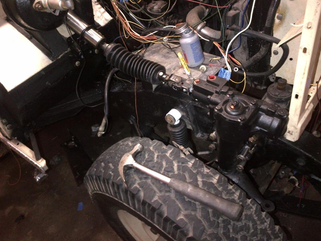

Installed 3 out of 4 parabolic springs and mounted my new Power steering pump. Now the tricky part of getting the new column to connect to it a semi professional looking way. Beast is really starting to come together. Pics to follow when she is sitting back on the springs.Comment

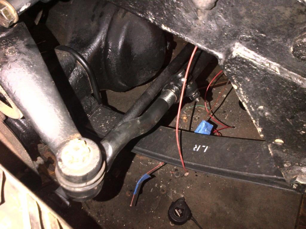

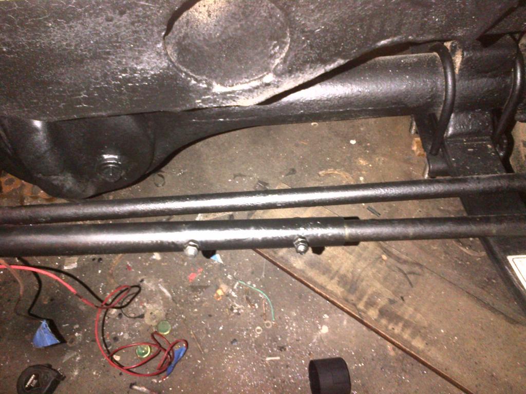

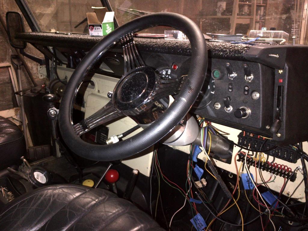

I finally got the new Flaming River Tilt column attached to the 2012 Jeep Wrangler Gearbox using a Shaft from a 99 Jeep Grand Cherokee. Next step is to get the Pitman arm to mount to the draglink. I will be cutting the S3 Link and attaching the jeep end to it. On the plus side it looks like the jeep links diameter is just about perfect to slip over the S3 one and weld. I also installed the new rear brake line I knicked with the grinder when installing the parabolic springs. Wiring continues on a daily basis. Hoping to head out to MOAB in it in May.
Still working on new power steering for my SIII and had a bit of luck last night. The Draglink from the original SIII steering when I cut off the gearbox end fit nicely into the 99 Jeep Cherokee Draglink. a couple of bolts later and the two were merged and I could steer the wheels again with my steering wheel! Next Challenge is getting a serpentine pulley for the engine - I don't think that was standard for Daihatsu.
