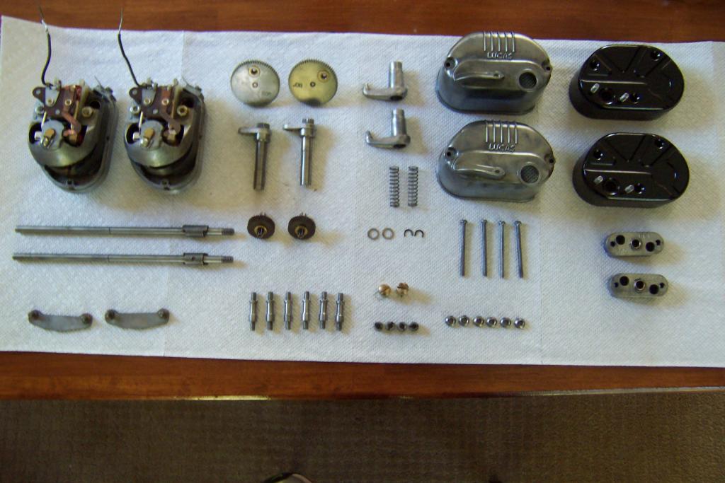

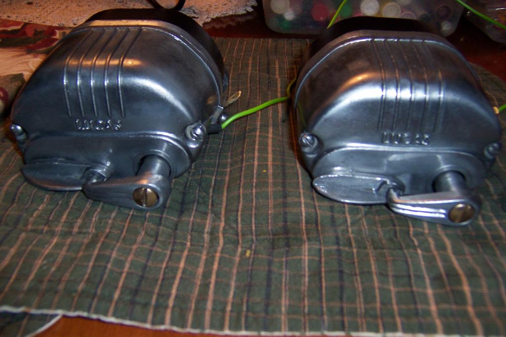

Thanks. I polished the front cases with a wire wheel, then clear coated them. I like the look better than if I painted them silver. As far as instructions, I didn't have any. I just kept track of what went where.Doug

Here's a page with some instructions on a the rebuild process: http://vivalaant.wordpress.com/2007/...refurbishment/Comment

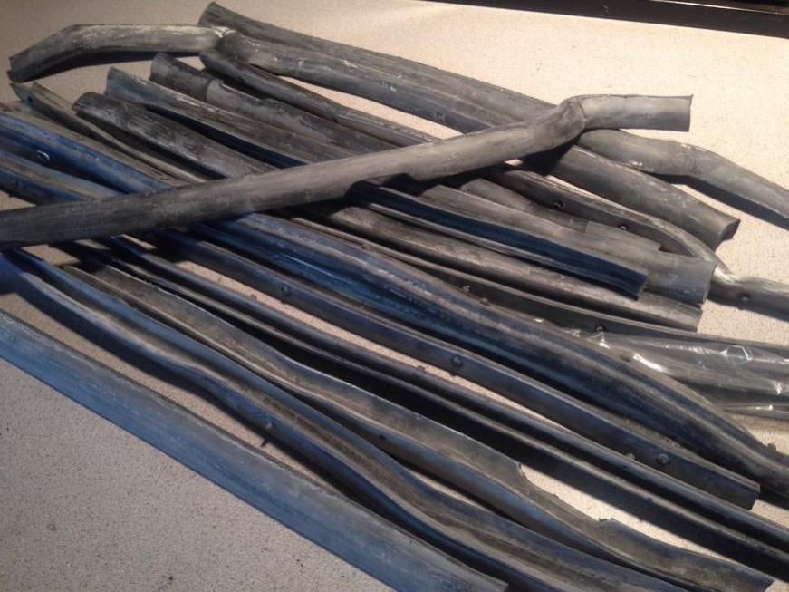

I did that once. A whole new set of genuine LR series door seals. I found that the doors didn't rattles as much but they didn't really help keep the wind and rain out. After a half decade or so I decided to remove perfectly good factory series seals that didn't seal and replaced them with a set of Defender seals. The Defender seals work MUCH better. It was the single best thing I did to keep cold air out while winter driving.
My opinion is that Series door seals are for show cars or ones that live in places like Phoenix, AZ where it never gets cold and 3 inches of annual rain is considered a good rain year. Defender door seals are a major improvement.-

Teriann,
Thanks for that info. I have struggled with the decision of original vs. modern door seals. I've had these seals on my shelf for years. They came from the LR Orphanage when they located the original molds and commissioned a limited run. They came out excellent, a nice pliable rubber with formed holes and pre-drilled alloy strips. I simply have to use them. Since I have defender roof sides, I will use the Defender seal for both the rear door seal and where the roofside meets the door top.
With regard to cold drafts, I can honestly say this has only been a problem for my left ear, which was resolved with defender military door tops. Maybe the old seals were not so bad, but either way my Kodiak Mk.IV keeps the interior more than comfortable...Tom P.
