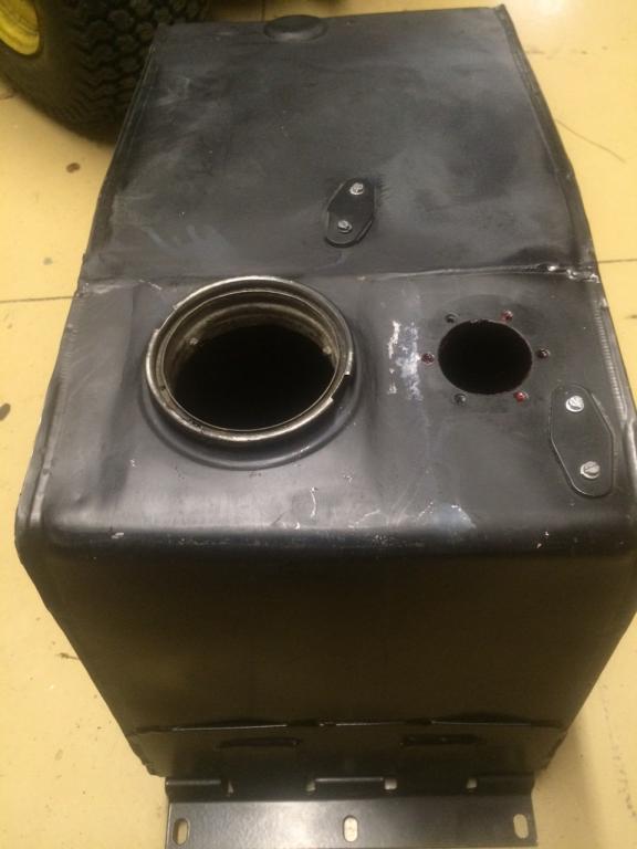

and blanked off extraneous openings. Had inside of tank epoxied.
Began the refurb of an FFR gas tank.
Drained old varnish, removed tank, - washed with phosphoric acid and chains. Viewed hundreds of pinholes from inside.
Procured new side fill tank - had top fill cap cut off of old tank and soldered to new tank. Blanked off other filler holes.

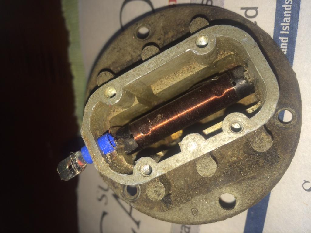

Resurrected 24V. fuel sender. Drilled out rivet holding spade terminal, listed out wire wound resistor, unwound 2 turns, reinserted resistor, inserted new spade terminal (swedge fit), and re-soldered.
Next steps: Add replacement float and arm, repair fuel line pickup

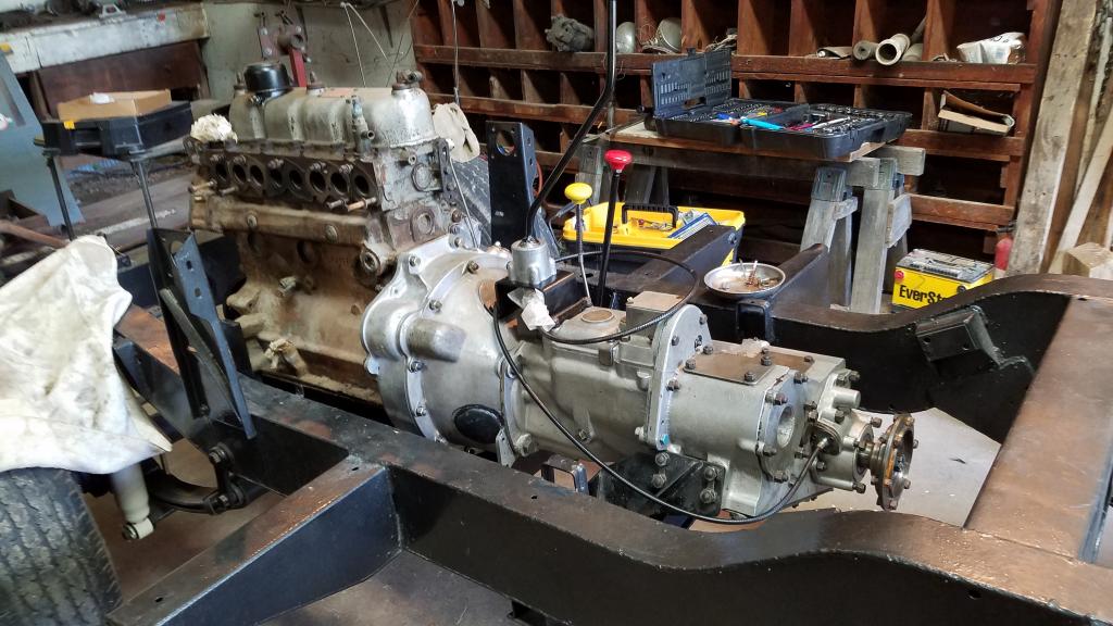

well this is actually over a few months. I rebuilt my 1954 2.0liter Siamese bore engine; cylinders bored out, new pistons, rings, mains, big ends, gudgeon pins/bushings, cam shaft, camshaft bearings, exhaust seats, exhaust valves,,..
Went to start it for the first time last weekend, it fired up and ran nice for about 10minutes then coughed a few times and stalled. Have not been able to get it to fire more than a few seconds since. Checked fuel pump and it's pumping fuel and plugs smell gassy. Have not been able to figure out where I'm loosing spark yet.THING 1 - 1973 88 SIII - SOLD

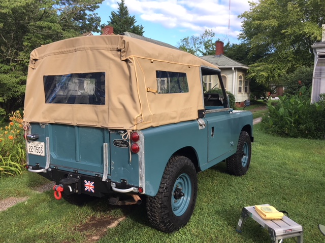

Today I installed a new Interstate battery. The PO had, for some reason, put a deep cycle marine battery in the Rover. Not surprisingly, the Texas heat killed it in this application.
Next week my new hoop set and canvas arrive so I can finally have a soft top!Comment
