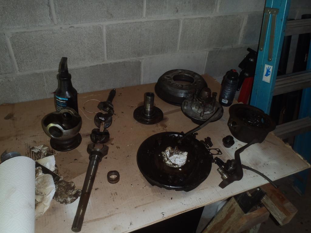

    working on replacing the front SPH balls, bearings and seals on my 54" and converting to a railco bush assembly. Completed disassembly of the front right axle. This truck has the older style tracta joint assembly. Removal of the bearing retainer is a real PITA.

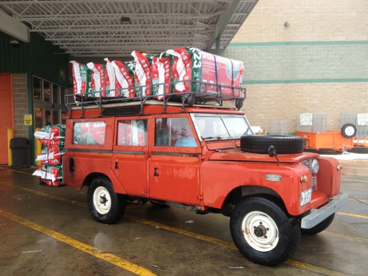

        Loaded up my Station Wagon with Insulation. Only needed 10 bags of it but if you buy 15 the price goes from $42 a bundle to about $33 a bundle . . . and I'll be needing more soon.
        If you have a roof rack and a hitch carrier you can just get 15 bundles on a 109 Station Wagon. The guys at Home Depot really liked the truck too!
        I wouldn't recommend putting that much on the roof if you had to drive a trail to get to a work site . . .

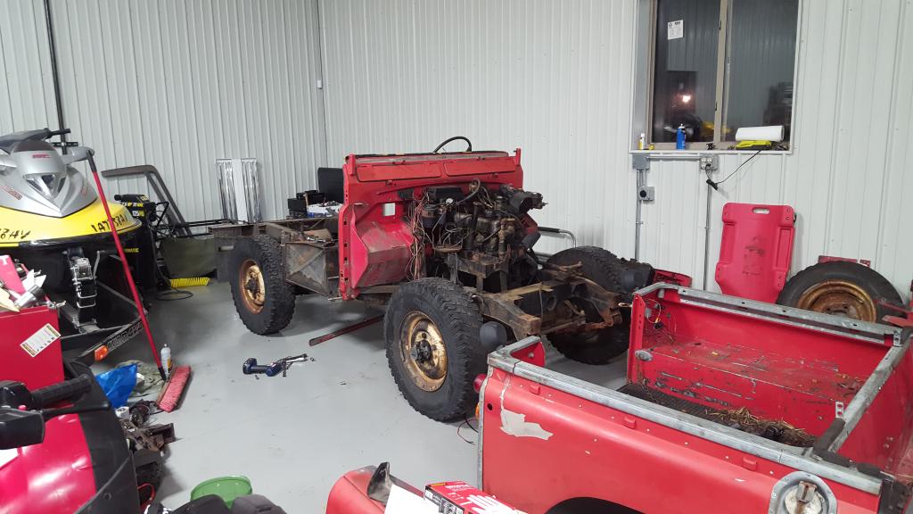

          got the turbo and intake manifold installed now just need to sort out the alternator, rad and inter-cooler. Long time not having Red Rover here but it feels good to have her back at home.

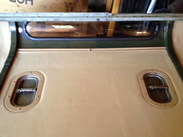

            Finished restoring the roof and doing the headliner.Click image for larger version

                HI Doug
                Nice head liner. Where did you find it?
                thanks
                1967 Land Rover 109
                1966 Land Rover 109
                Joshua Tyler
                • DGG
                  2nd Gear
                  • Nov 2006
                  • 304

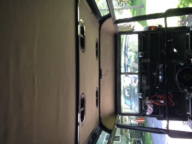

                  I made it myself. I used some 1/8 self adhesive sound deadening foam that I stuck to the metal roof, and then glued headliner material to that.

                    Sorry the pictures are sideways. I don't know why they are like that.
                          [ATTACH=CONFIG]10859[/ATTACH]
                          I also did a SPH rebuild on my '69 IIA. The driver's side has had a wobbly wheel for what seems like years- it made getting inspection stickers a matter of pleading with mechanics that it wasn't that serious. I finally tore into it and got a new kingpin driven into my existing steering arm. This has old steering arms which sit on top of the housings. A new swivel ball, bearings, seals and sundries. Very satisfying to feel that front wheel now sitting as solid as a rock. I also made the acquaintance of a local garage that has a press and will do bearings and so forth essentially for free.
                          I have a set of the leather gaiters on order- what are people's opinions on those? I had an old set on there and the balls under them were pitted and rusty; are they actually causing more damage than they are preventing?

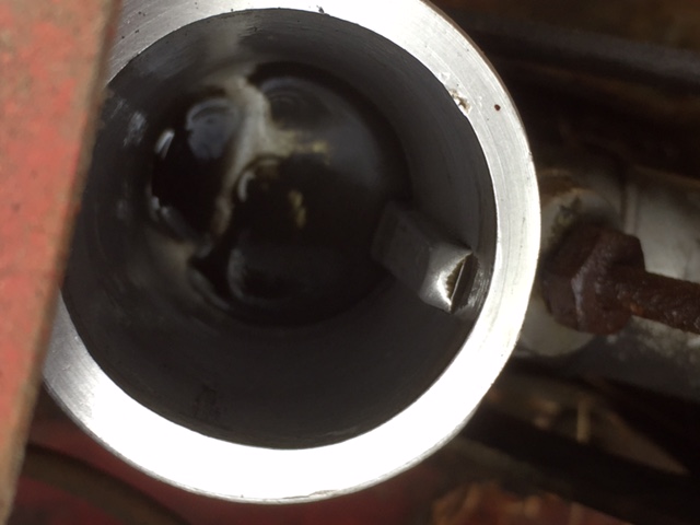

                              Changed the hydraulic parts of the clutch system and boy did it need it. Though the fluid up on top of the reservoir looked nice and clean there was quite a bit of sludge at the bottom. I also took a chunk of some seal out of the master cylinder reservoir . . . not quite sure how it got in there!
ID:	169608 The sludge at the bottom
ID:	169609 The solid piece of whatever . . . maybe it was trying to make a new seal . . .
ID:	169610 What the fluid near the bottom looked like eeewwwwwww!

                                Ref the gaiters, depends on where you are. In the salt belt, if they get torn they retain all that nasty stuff and it festers away. Though, if they are looked after and kept supple with dubbin or leather softener, they can keep the corrosive stuff at bay. Long and short, yes - a good idea but need to be attended to (along with all the other items -topping up, adjusting, cleaning etc).
