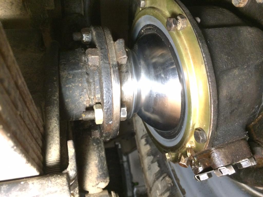

This was this first [what I call] major work on the truck for me. So I took it slow. I had previously only replaced a manifold gasket, overhauled the Rochester carb, and replaced rear axles (went to chromoly). I installed NOS swivels, so a little more than the seal if you count the bearing and railko bush.
I basically did one side, and waited for a few days to see how it stood up. The ball and seal looked great, but I began to see leaks from the bolts and the drain plug (note that I'm using EP90, not swivel grease). I also have Series II swivels set up on my IIA, which means the steering arm is on top, and the bottom pin has no o-ring.
I was advised to pack the pin with SIG3000 sticky grease. So on the other [untouched] side, I did this and waited a few days before tearing apart my new work. I also replaced the crush washer for the drain plug. No leaks on the other side after two weeks, so I got back into the first side I did and repacked the pin with sticky grease and so far everything is holding up really well.
What really helped me with the process was a video on YouTube. Do a search for "land rover swivel ball" and you'll see it.
So the first swivel took me a couple of days. The second one took me only 4-5 hours. When I got back into the first one to repack the pin, it took me about 2-3 hours (but all I did was R&R the hub, preload, etc.).
I have to say that the whole thing has been pretty rewarding. One of the reasons I got the truck. I'm really cutting my teeth on it and it's quite satisfying! Feel free to hit me up with any questions. It'd be nice to finally help someone else out for a change.

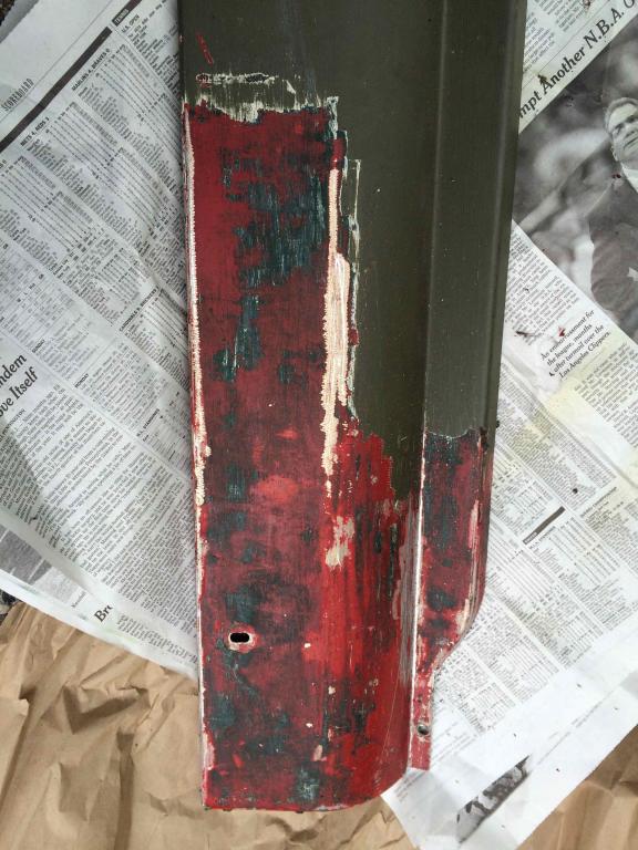

Started prepping body for some new paint. Used Aircraft Paint Stripper on the Apron Panel on Ex-MOD Ambulance to see what I am in for if I repaint. It was like a trip down memory lane. At least 3 layers of paint. First 2 look like original primer and Red Ambulance Paint, then another decent Dark Green coat of some sort, and then the dreaded Latex House Paint layer I am thinking about removing. It is going to be a long and "interesting" project.

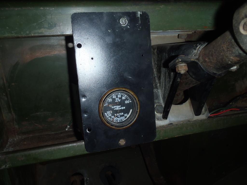

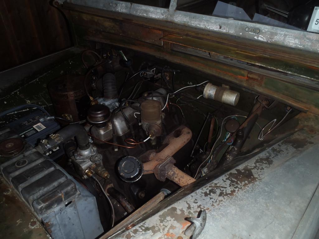

I worked on the 54 this last weekend. I just got plates for it and took it for a little ride. Got out and ran my hand along the left fender and it was quite hot? So I decided to install a dual gauge that I had rebuilt to check operating temperature. Temp leveled out at ~70 DegC so seems to be running at good temperature. Must just warm up more than my other trucks.

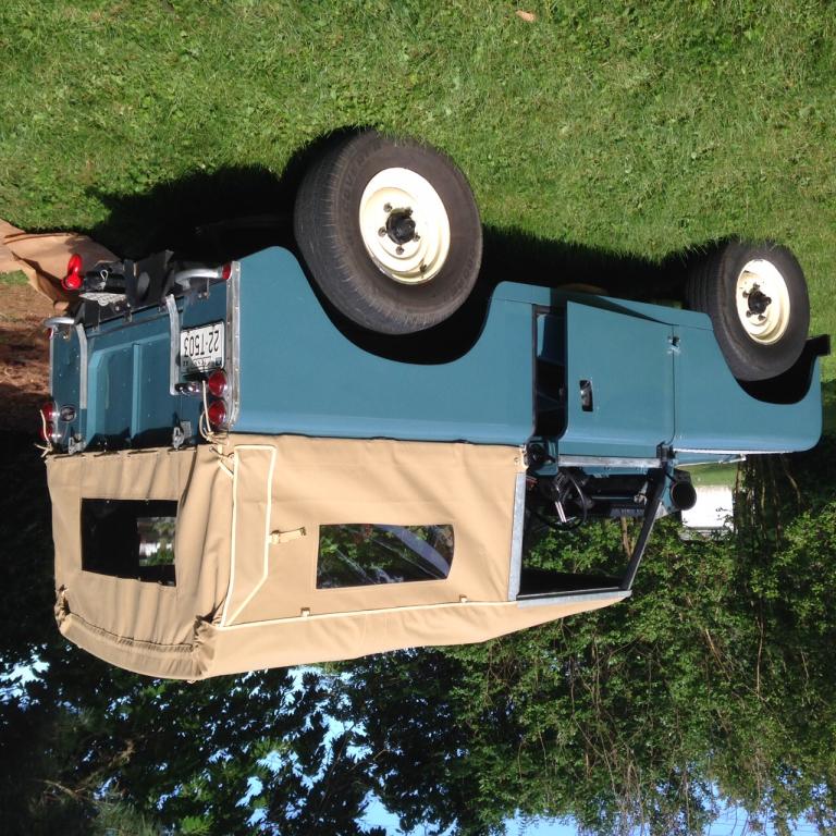

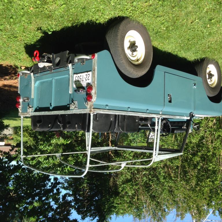

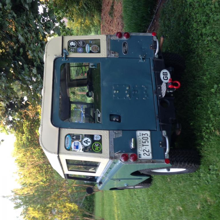

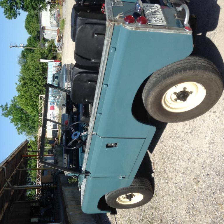

Could someone please tell me how to get these images rotated properly, however here's my day!
Today my Rover went from:
To this:
To This:
And finally to this:
A full day, but a great result! Now, when I get the Wolf wheels back from the powder coater in Marine Blue.....'65 Series IIA, 88'

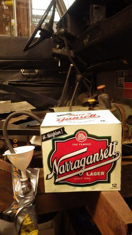

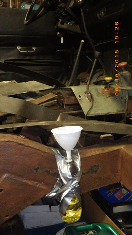

Added new "fuel cel" since the old gas tank is kaput and removed. Started the Landy for the first time in over a year, little carb clean to the carb, crank it a few timew, a couple of coughs, and shazam!!! now it starts first turn of the key. Now to finish cleaning the garage of "detrietus" that has accumulated over the winter, and be able to begin frame repairsComment

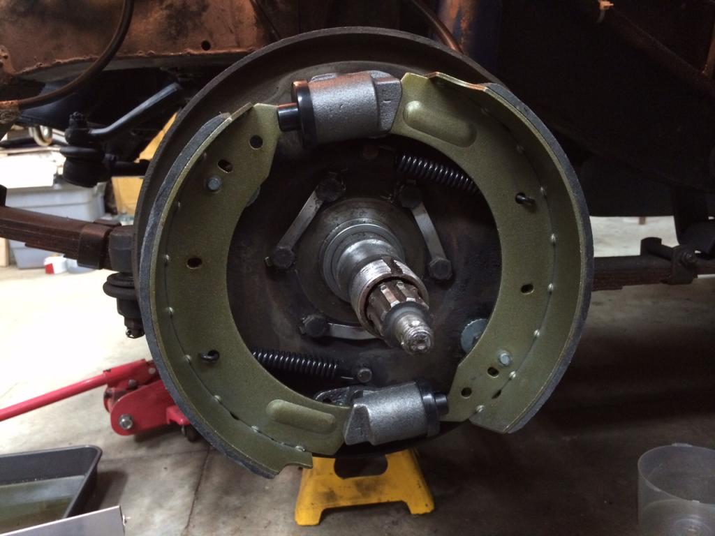

Josh,Had a lot of brake issues. Brett and Linus from Santa Cruz have re done the front brakes on my 1967 Land Rover Station
It has 11 x 3 brakes, and now a new set on drums installed[ATTACH=CONFIG]10802[/ATTACH][ATTACH=CONFIG]10803[/ATTACH]
Also, shoes,Cyl and brake adjusters
josh
Where did you source the drums from? I am in need of a pair but they are very pricey.
