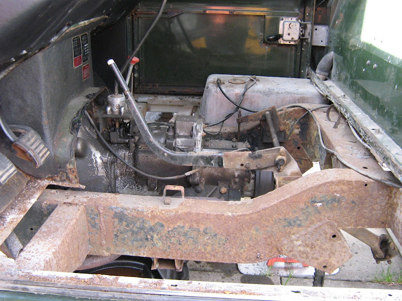

      Shortend my original frame with the sawzall, Left the 4 pieces at the end of my driveway as "FREE scrap steel", Gone in 3 hrs
        You know...
        ...the sad thing about looking at those pics is that the chassis you cut up looks like it is in better shape than some parts of my current chassis.

          Yeah..I've seen many much worse...It was weak and rusted through in many areas, though not totally rotted. Ive seen articles in LRO mag making worse frames slook good again.. I had no time or desire to restore that one. It would have needed considerable plating to restore the weak areas and new rear x-member

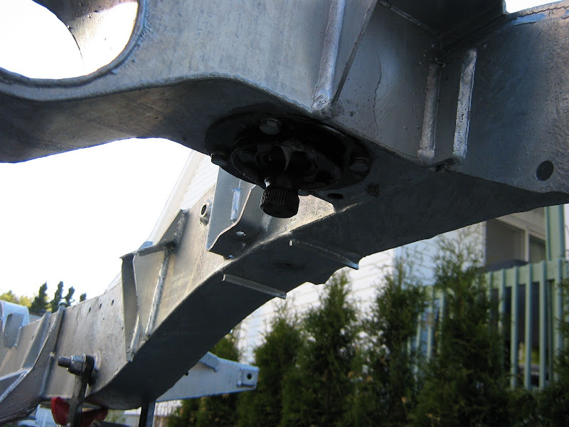

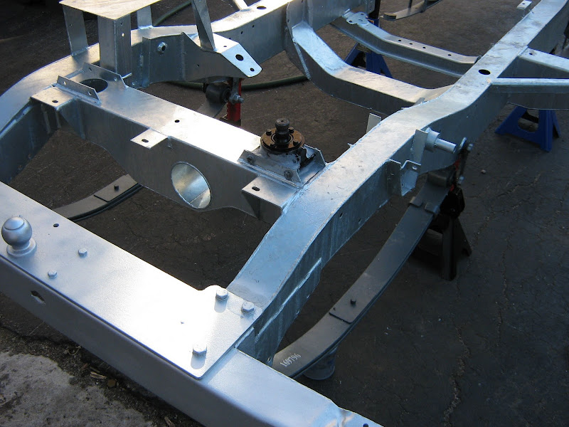

                            Sunday I did start to remove stuff from the interior.
                            And today I did install the stering relay in the new chassis. Load of anti-seize whent there...And I did sealed the upper part to keep sand, mud and water from getting in-between the chassis tube and relay. So I will tell you in 35 years from now if its seize again and if it will be easy to remove.

                              Martin--What's that plate with the tow ball on the front of the new chassis? A towbar attach point?
