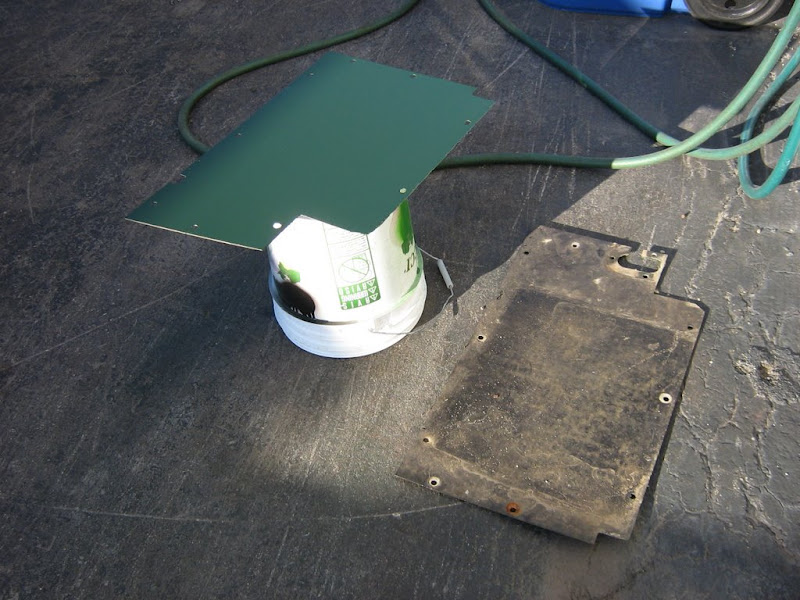

          Today I when to the auto part store because they can make you any color you whant in a spay can with much better quality paint that what we found in any hardware store. So I did tell the guy to make me a can of bronze green paint for testing. I dont have the equipement and money to make a proffessional paint job so I do with what I can do and afford. I also bought a quality spray can primer and cleaned one of the floor pannel for testing and here's the final result...
          And here is the passenger side floor pan compare to the one I did. They where both in the same condition before I touch them.
          I will let it dry all night and tomorrow I will test how rugged the finish is. Maybe I will spray paint the entire truck...exept the roof becaus its in perfect shape. I will use the truck in the wood anyway and it won't be a trailer queen. So paint job is not the number one prority. Someday when I may be ritch I will pay someone to do a pro paint job on it...

                Would love to hear how it holds up - might be a good solution for my top.

                      Ill keep you updated on this. I have only done one floor panels so far. But what I've learn after painting it is that you need a special primer to paint over aluminum. I did not have that when I did my panel. So maybe it won't hold well. I read that you need aluminum oxide primer. I used standard stuff. I will go back to the auto part store after work tonight and see if they have some and make another test on the other floor panel.

                          When painting aluminum you need to use self-etching primer, available at most auto parts stores and marine-supply stores.

                            Can the etch primer and go with an epoxy primer instead. read the instructions, and top coat within the appropriate window of time.

                              I use epoxy primer when using a gun, but when I want to rattle can it, I use U-Pol Acid 8 primer, been using it a long while and it works well. (just a piece of advice though, the metal has to be bare to use it, if you spray it over any old paint, the old paint wrinkles up badly, pretty aggressive stuff) you can get it at autobody supply places (or online for about half the price supply places want for it). U-Pol is an English brand, so maybe they're thinking of Rovers when they made this stuff.
