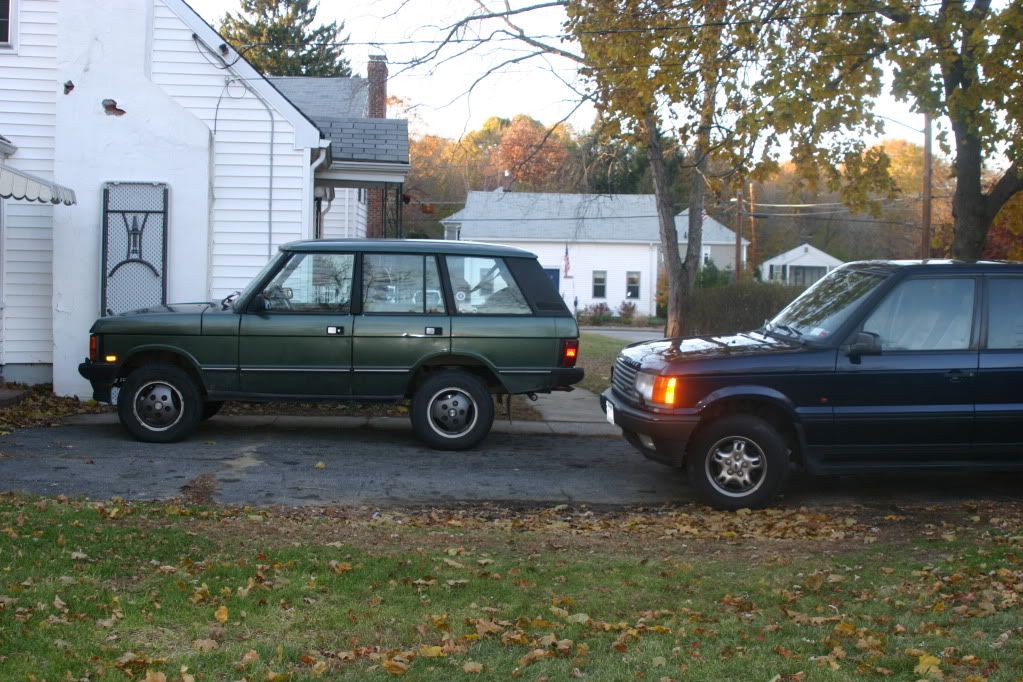

                On the SWB RRC:
                Adjusted track rod and tie rods, steering stops. Vacuumed out the rear area, wow, just wow. Did someone have a mud pie fight back there?
                Made front license plate mount.
                Ran it thru the wash.

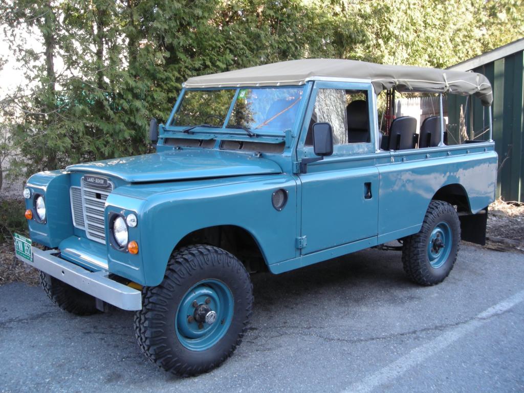

                  Ready for summer
                  Canvas top, +2 jump seats in the back...ready for summer.
                  No, its not a Jeep...update, actually it is for right now. I am temporarily Rover-less.
                    Nice.
                    I'm pulling everything above the body cappings, folding the windshield and going for a nice long drive on this beautiful, 75-degree last Sunday of winter.
                      Thats a nice looking Rover!

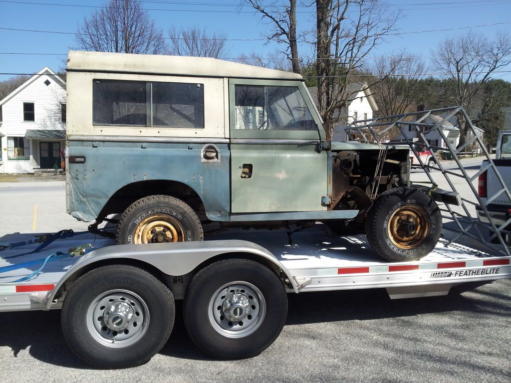

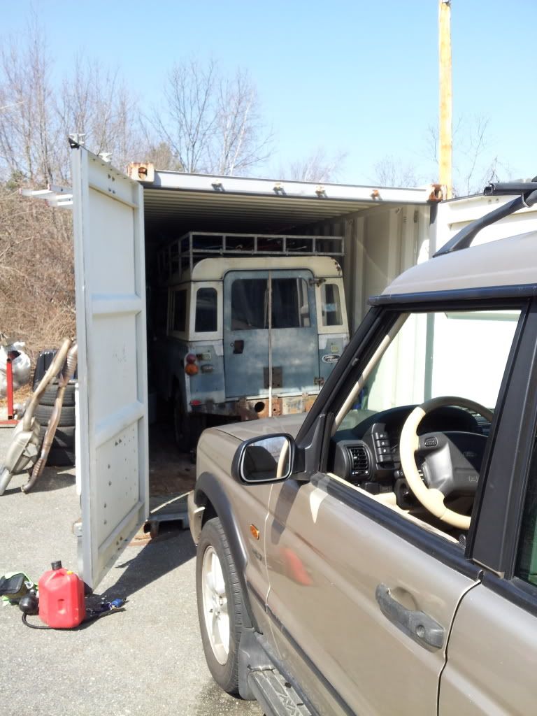

                        Bought mine!
                        Added it to the family: 72 Ser III. She's rough but I can see past it all. I couldn't be any happier this weekend.

                            Bought mine!
                            Ike's gonna love you. The Brownchurch rack is worth the whole rest of the truck.
                            Hope the engine and drive train is in better shape than the body.
