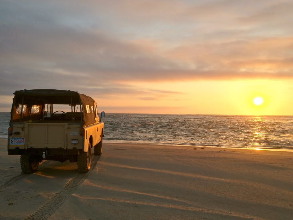

Beach trials today. Put the tires down to 15 psi and drove the 109 out to the west end of the island today (Smith's Point) and it was awesome. She has always dominated the sand, but with the new BFG's it didn't even break a sweat.

Masonater: Do you ever take this truck to Martha's Vineyard? I saw one much like it in Edgartown last summer (or summer before that - can't remember). Tried to chase the guy down, with no success.Comment
