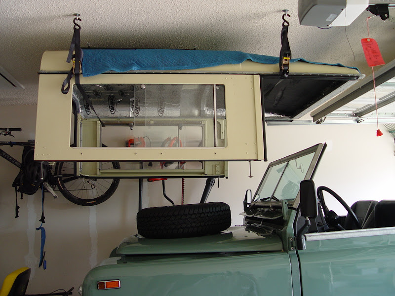

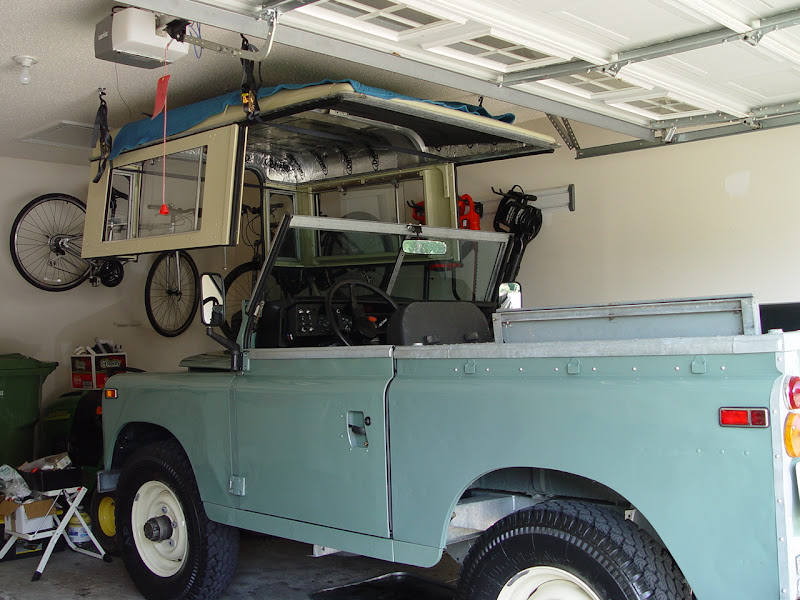

One man roof lift
Here it is...
Materials:
4 - Eye bolts
4 - Lock Washers
4 - Nuts
8 - Washers
2 - 2x4
2 - 2x6
2 - Ratchet Straps
I took the 2x4s and 2x6s and made some what of an "I" beam....or more of a "L". My thought was that this would had some strength. Drilled holes through the drywall and the beams and attached the eyebolts.
Attached the rachet straps to through the windows, undid roof bolts and began to rachet the roof up. I placed a moving blanket on top of the roof and placed the door tops up there.
