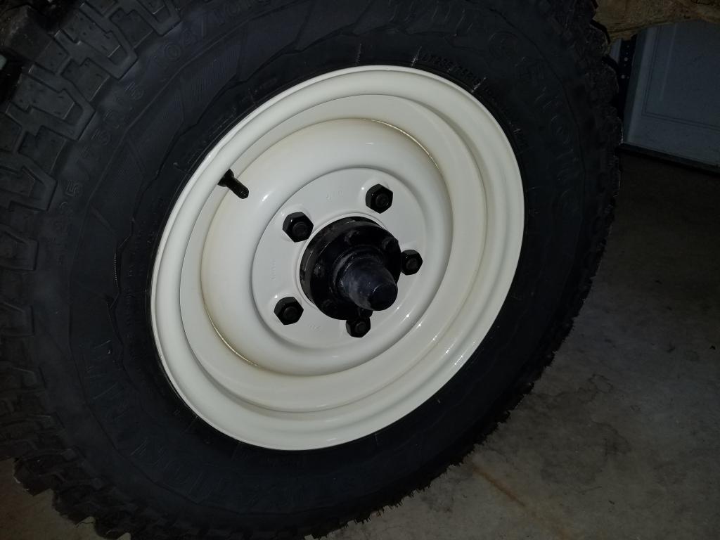

                  Posting some more pics of the progress. Close up shot of the powder coated rims and powder coated lug nuts. Well worth it.

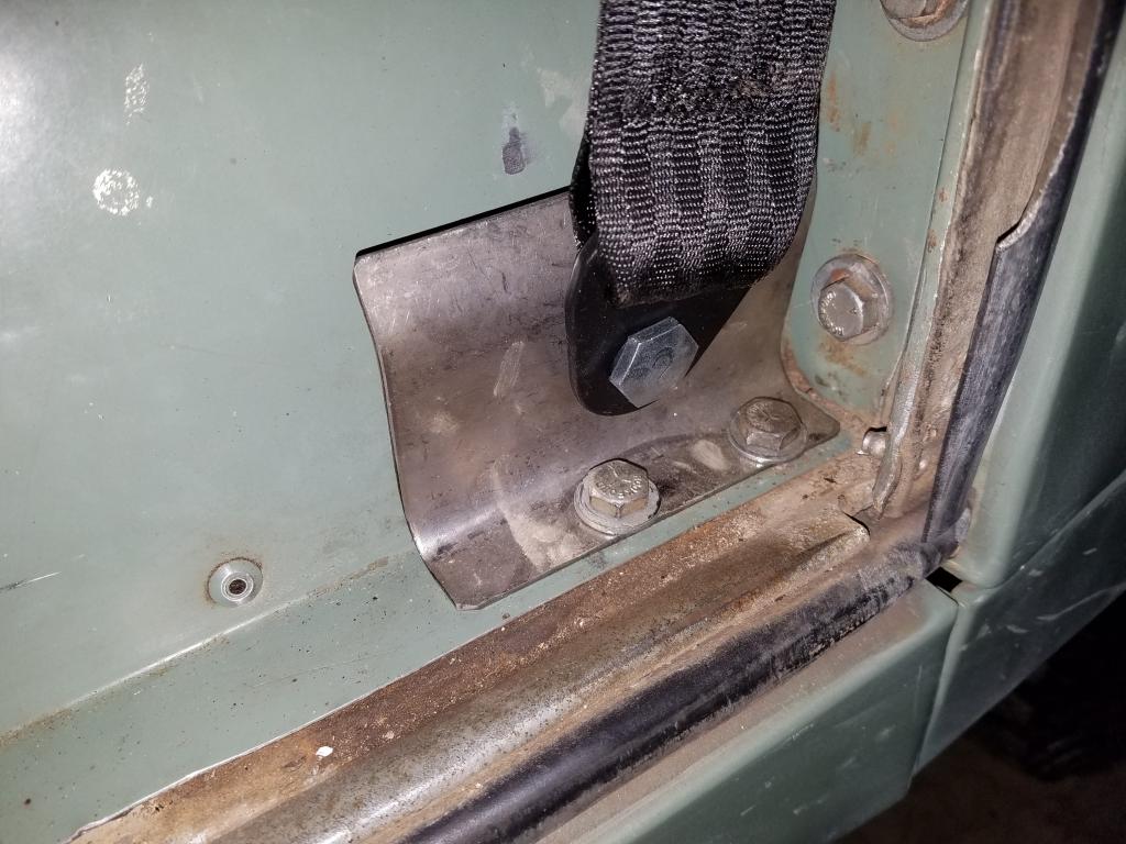

                    RN does not have the LH seat belt bracket, so I just made one. Took a while to get it where I needed it, but gets the job done now.

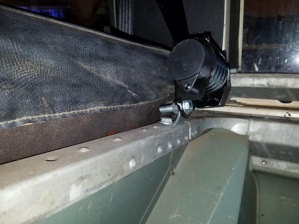

                      I bought the three point seat belt kit with reels. Good news is that kit comes with multiple brackets assuming you may have a different mounting angle. I used the pre-drilled holes on the backwall and brackets that came with the kit to mount the reels. I needed to mold them to the angle needed. And for the buckles, I used the L brackets from the kit since they simply would not work otherwise.

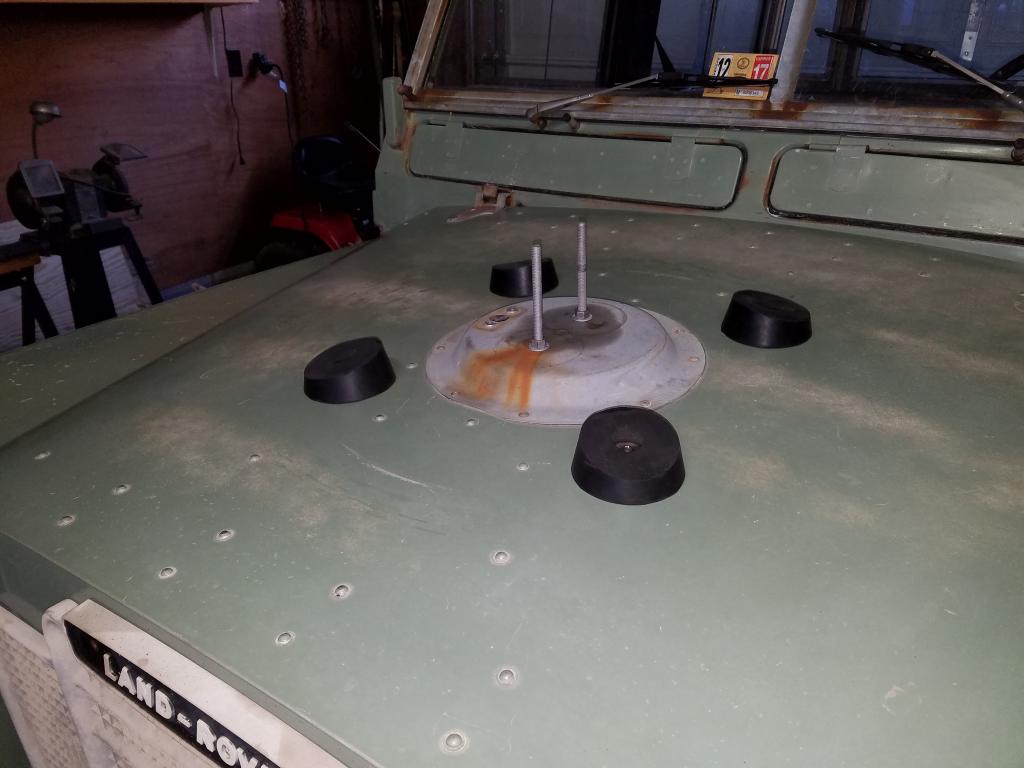

                        Here is my homemade solution to the bolt that was sheared off in the pie plate. I drilled a hole through the bolt and used two galvanized bolts with a fabricated braket to go across the rim to secure it. When I first mounted the tire, the factory rubber stoppers were barely making contact with the tire. So I opt'ed to get some large rubber stoppers, drilled the center out for the bolt and washer. Then I cut the top to an angle so the tire can rest comfortable on the stoppers with about 1/4" clearance off the hood.

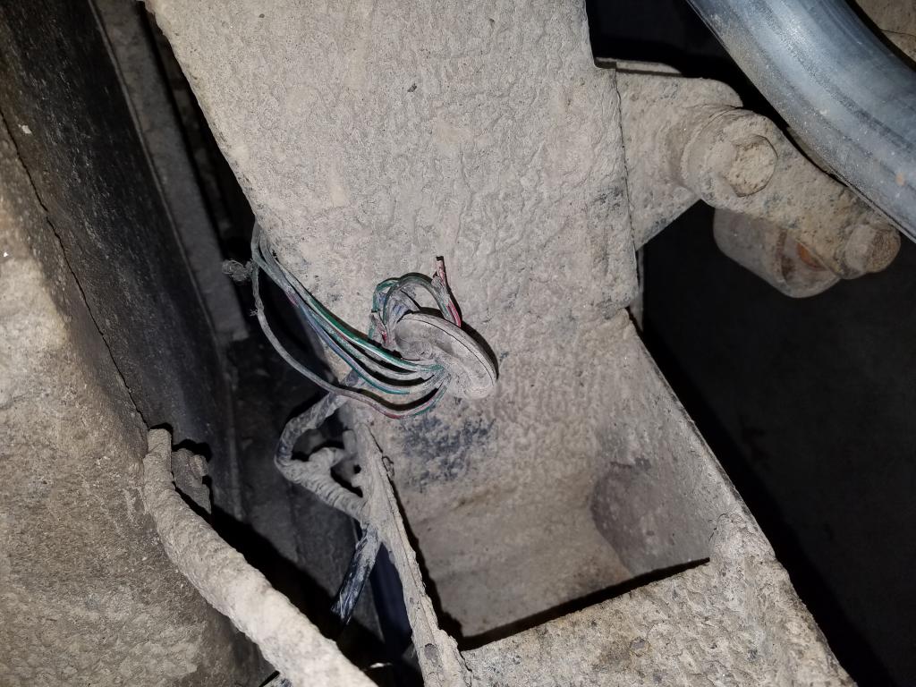

                          Found out why my tail lights were working intermittently. The tail lamp wiring was partially broken coming out of the frame and the rubber grommet was out of place. Fixed up the wiring and got the grommet back into place.

                            Those rims look awesome!
                            RN might not have lower seat belt anchors, but other vendors do. Call Ike. Call Trevor. p/n 345101.
                            --Mark

                              Yeah, I was surprised at how good the rims came out. Had no problem giving them my money...lol. As for the bracket, I am sourcing a factory one, but I went ahead and did that because I had nothing. I really wanted to keep the factory seat belts, but the buckles had seen better days...felt better with a new kit.

                                I have a couple of the used brackets (LH and RH) as these now come embedded on the new Defender seat belts.
                                Pay the postage and they are yours.
