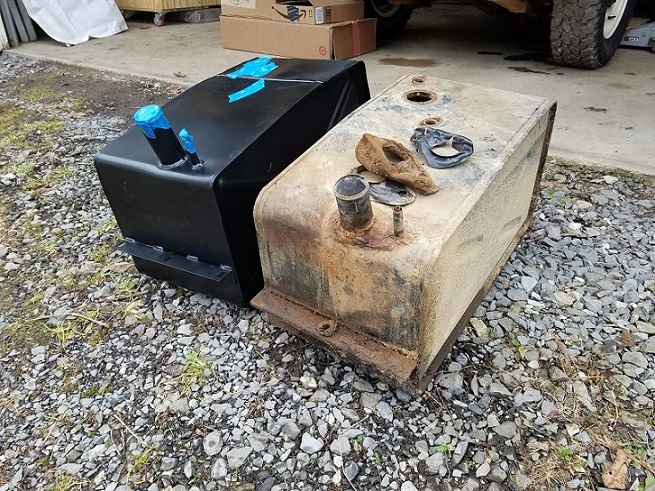

So on to the next major challenge...fuel. Since I got the beast running, she has been spitting up rust and various material from the fuel tank. We had two fuel filters installed in hopes of cleaning it out. But it just wasn't happening. It would run clean for a few miles and then out of no where, total blockage and stall. Today we pulled the gas tank to take a peek. The floater has started to breakdown. The shell of it is breaking apart and is being sucked up. On top of that, the tank itself is covered in rust which is also being sucked up little by little. I will get some pictures of it tomorrow...but went ahead and pulled the trigger on a new tank, gaskets, etc. I still might try to recover the old one, but felt better with a new one. I am still going to coat the tank when I get the new one. I think the new sender has a low fuel sender on it...and if so that will be cool to get online.

Take a look at the fuel draw tube as well. There is supposed to be a mesh "sock" on the end that screens out debris. Sounds like this may be missing as well. That's the first line of defense. Second in the fuel bowl - I'm sure you've pulled and cleaned it. The third line of defense is the in-line fuel filter, which is sounds like you've been using.
When installing your new tank, be sure to use the two rubber grommets that are sandwiched on the single, rear tank bolt/mount. These are important to making sure the tank mounts can flex - vs cracking the tank.

At some point in the distant past, an electric fuel pump was put in. So my sediment checkpoints are both in line filters which are see through and are easy to maintain. Once the new tank is in...the filters will be on easy street.Consecutive drives without breaking down: 3Comment
That sock was gone...when I was hunting parts online I found out that piece was missing. I am not buying an entire pickup just for that...I will see what generic ones I can get for a few bucks. Those rubber washers were also no where to be found...lol. Prior work to the gas tank was done to fix a leak...who knows possibly because those were gone. But at the end of the day, they put it back together with leftover parts (rubber washers/pick up screen). God knows what else is missing on my LR. I should have most of the parts in before week's end...so should be a fun weekend

Replacing the tank is a good call. Starting with clean fuel solves a lot of problems :-)

So we have been working on putting in a new gas tank. Below I got a shot of new hotness and old and busted. I would still like to try and salvage the old one, but not depending on it at this moment.
I went ahead and coated the new tank with Red Kote...was an interesting new experience...lol. I let it cure for one day and then we started to mount the new tank.Consecutive drives without breaking down: 3Comment
