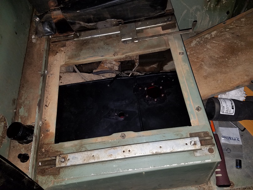

The new tank was a tighter fit than the old one, but we got it in there. I found out the hard way that whomever had the tank out before (fixing a leak) did not put it back in with the right bolts and rubber washers. Anyways, we are fixing all of that in one swing.

The new tank sealant finally cured, so we plumbed up the tank and put fuel in it today. It has a new tank, new sender, tube sock, gaskets, etc. After sitting a month with her pants down, she fired right up with little effort (good news). Getting clean fuel out of the tank (as you would expect). However the fuel gauge is now about half of what it should read or somewhere in there. I put in about 5 gallons and I show 1/8 of a tank. In reality, I should be just under a half tank or at least 3/8. (bad news). I have read about multiple possible causes for this.
1. New sending unit and original fuel gauge are not compatible (gonna double checking my packaging, but what I am pretty sure I got was PLE494 which should be compatible. It is the only proline one for the S3.
2. Incorrect wiring of low fuel vs gauge. According to what I have read, T = gauge and W = warning light. That is how I have it wired. I have run a wire for low fuel, but not finished the wiring on the engine bay side for that yet. So no issue here that I can see.
3. Improper voltage at fuel gauge potentially due to voltage regulator. I have a hard time with this one since it was working before the swap
4. Defective sending unit
Any other potentials? One experiment I want to run is to compare impedance of the current sending unit (as it sits) vs my original sending unit. I was reading (in various threads) the resistance swing is somewhere around the 240 Ohm to 24 Ohm range (full to empty). I think this can help me narrow down if the sending unit seems to be working properly and that the issue is downstream.
Other bad news is that my LF hub gets hots after a 10 mile drive or so. Looks like works needs to be done there. (other bad news)Consecutive drives without breaking down: 3Comment
