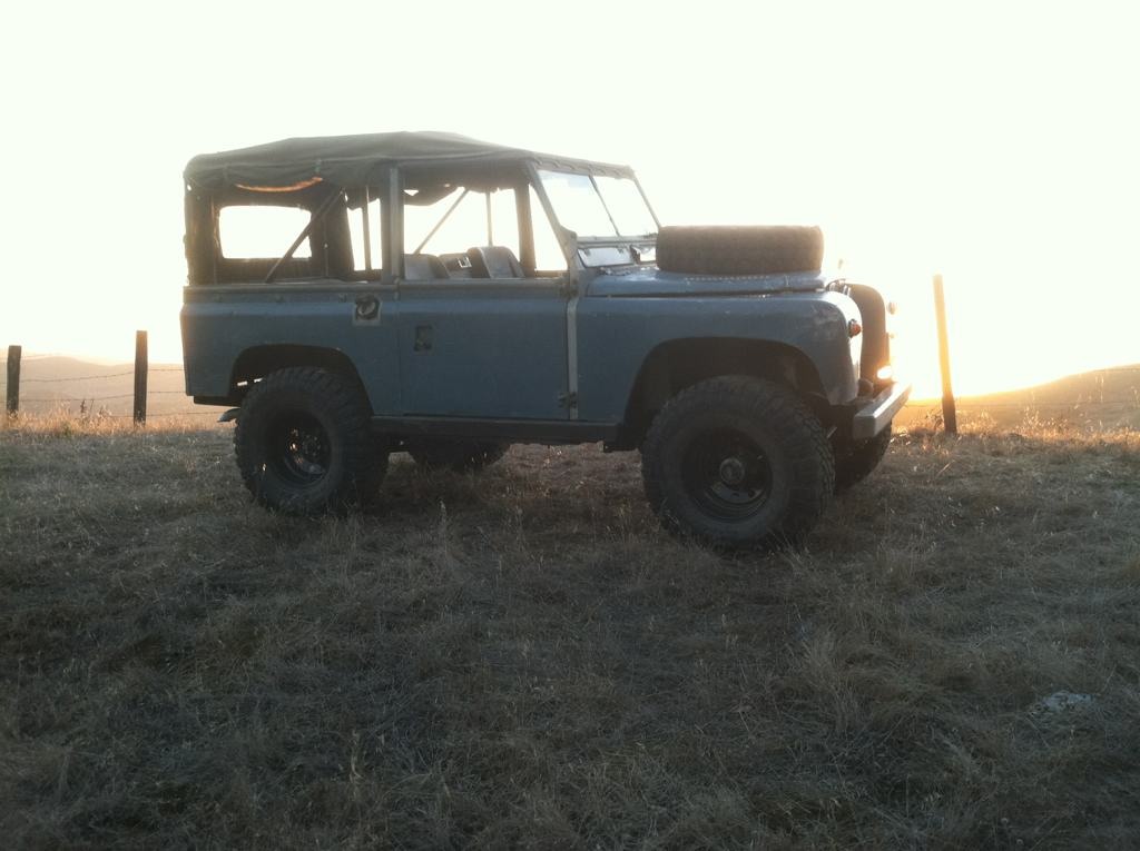

                • blue bomber
                  Low Range
                  • Dec 2011
                  • 48
                  #68

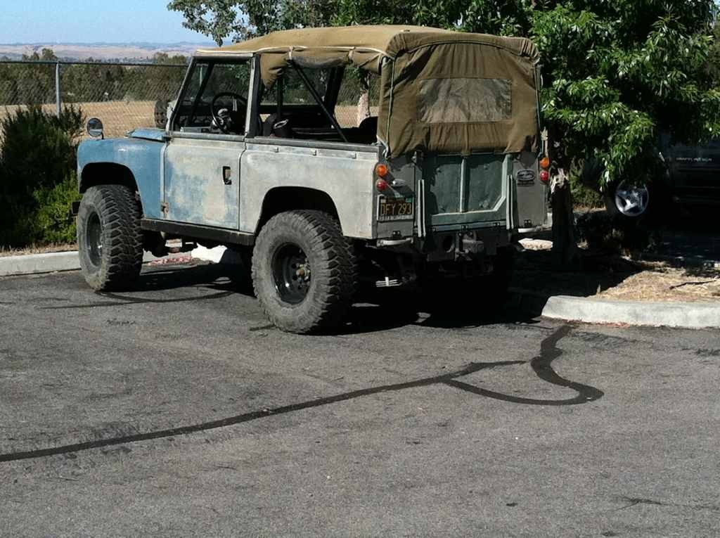

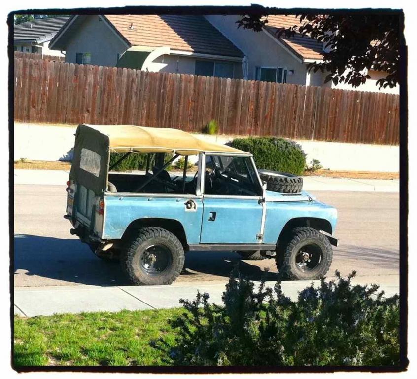

                  I have a helpful hint when using these canvas tops. I was experiencing exhaust stink wafting into the cab any time the throttle was released. This may not be an issue with a stock style pea shooter muffler and tail pipe. But in my case, both the 2.25 and the 5.7 vortec, were killing me!!After multiple attempts to figure out how defeat the stank!! It took a quick history lesson to smart me up. If you look at a WWII MB jeep,the canvas is open except the rear. It is pulled down. Magic!! I just rolled it down and now it's gone. I can haul butt down dirt road without a dirt swirl coming in the back. Check out these images. I hope this is helpful .Click image for larger version

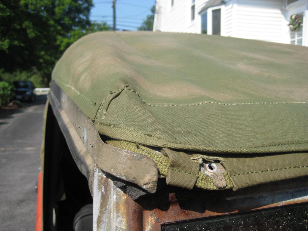

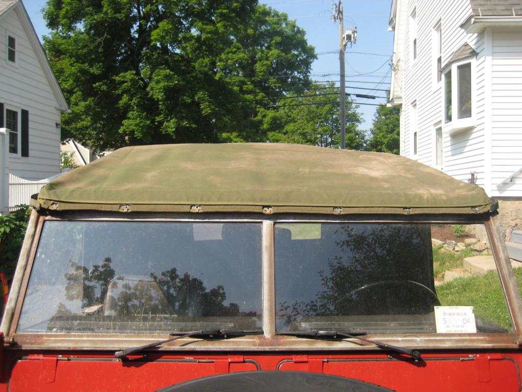

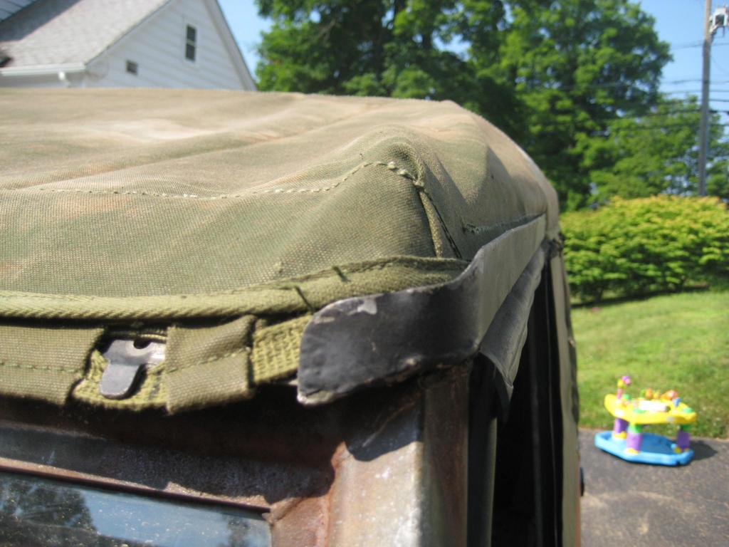

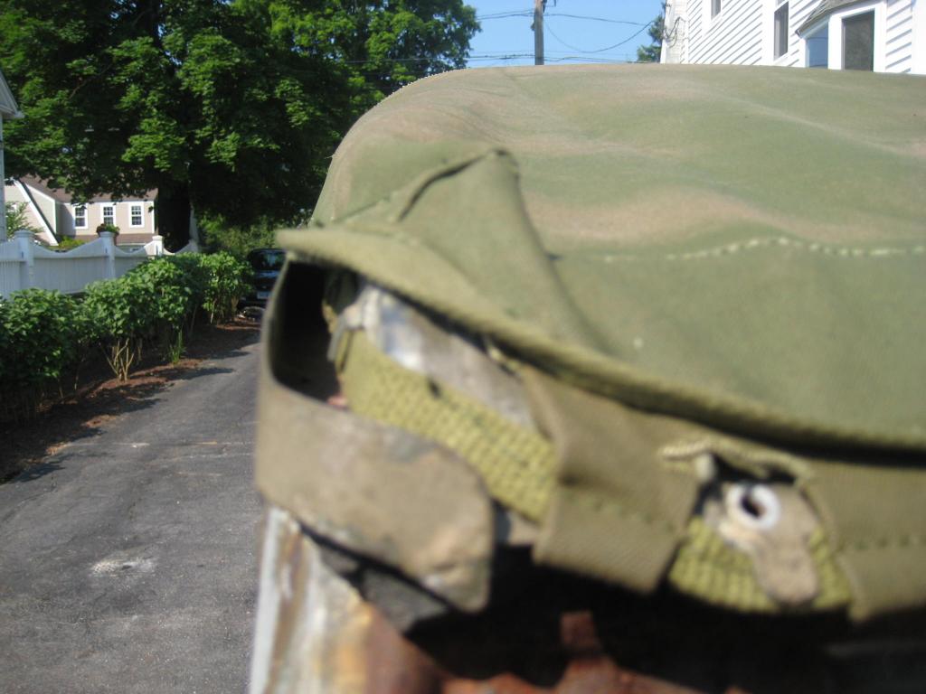

                    Put a soft top on for the first time yesterday and unless I am missing something I am not to impressed with how it fits along the windscreen/doortop corners. It is brand new though poorly stored by the previous owner so has discoloration. It seems to be that the corners do not stay where they are meant to. I have watched an install video and they say it will be a bit loose there to allow for shrinkage. As far as I see it if it shrinks it will be even worse there. I posted pictures as it lays by itself but also how easy it is to pull the corners up and I assume wind when traveling would cause it to pull up even more there. The strap along the windscreen and drain channels is tied back as instructed and makes no difference. Is this just how they are? and why after 60+ years of soft tops is there not a better design for a nicer fit?

                      ^^The front piece with the 'tines' on it should be up against the windshield frame. On my SIII Lightweight, this piece is actually riveted to the windshield frame using the hole at each tine. This will bring the front edge of the top down, and will keep it in the gutters as well.
                        Thanks for the reply, so if I follow you correctly I would have to bend the front rail downward to get it to touch the windscreen frame and then drill into the frame and rivot it? I am just not sure I want to drill my windscreen frame as now that its on I am kinda thinking its not as practical for me as the truck top I run it with.

                        • jac04
                          Overdrive
                          • Feb 2007
                          • 1884
                          #72
                          I would bend it so that it is tight up against the windshield frame. Since you switch between tops, I agree with not riveting it.
